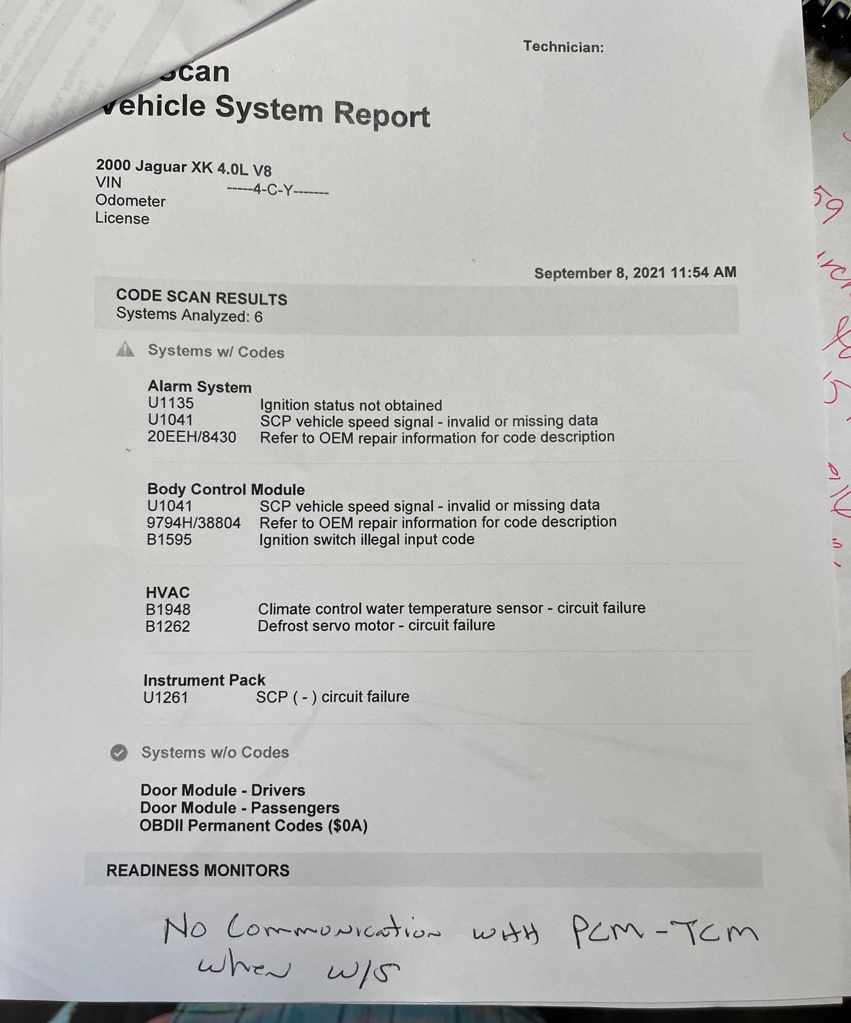

Hi. I am new to this forum and, to be totally upfront, not mechanically educated when it comes to cars. I have been having issues with my XK8 randomly not starting. When it starts, it runs beautiful .
When the car doesn't start, I can’t pinpoint any specific reason why. I've run it for hours, stopped for gas and it won't restart. I've tried to take it first thing in the morning and it won't start. I've driven it for months without a problem, then bam, it won't start. I had some other work done on it two weeks ago, drove it home and it hasn't started since. The link below will show you what I see on the dashboard when it doesn't start. The words “system check” appear and then a series of warning messages scroll. Some of these messages are fatal warnings (transmission fault, brake fluid low, asc), thereby preventing the car from starting. None of the items in the warning messages are broken but because they are fatal errors, the car won't start. Something is triggering the messages or as I am learning, it may be the instrument pack itself that is faulty. The car does not shut down once it's started. I don't get any sound when I turn the key. The dash, windows, lights, etc., all work.
Dashboard messages
https://share.icloud.com/photos/0d8v...Lgu4vYUaK2vfgA
A mechanic friend was able to run the codes because the car didn’t start for him while he had it. They are at the bottom of this post. I took these and the car to a Jaguar dealership. They told me I needed the following part number but said they couldn’t get it for me. LJD4300GB104

I beleive the vehicle speed signal comes from the LH front wheel toothed sensor . Maybe sensor failure .. or damage to the toothed wheel ..cracked or slipping?
Swop the sensors left to right to test.

For the no start (I mention this because of the B1595 and U1135 codes) - in start situations, there is a delicate dance between the key (CHIP), Exciter Ring (ER), the key transponder module (KTM), the body processor module (BPM), major instrument cluster (MIC) and the engine control module (ECM/U) that has to be jus right for the starter to turn, fuel pump to pump and the spark plugs to spark. It sounds crazy but it's basically a security feature ALL initiated by a chip in the KEY that is read/sensed by an "exciter ring" right near where you insert the key. If something is off in this chain of events the starter will seem dead. Car will not start.
Once, in my car, the door/window was left ajar and water got into the KTM that is situated right behind the LH most blower vent in the dash. Long story. I won't bore you with it. Jus to say, it killed the "start up" security check process. Later I learned (again, long story) that the BPM needs to be well grounded to operate properly. It's behind/under the dash just being the glove box. So,,,
Brotha/Sista, you may have some digging to do.
But, will it be you doing it, or someone you pay?
Oh - The ABS light might just be a crap or low battery,,, light MIGHT go out once driving and you get up to 5 or 10mph.

The Technical Service Bulletin may well be relevant, but easy checks first.
How old is the battery? What voltage is across its terminals with the ignition turned off after, say, 1/2 an hour?

Agree with above ^^^. Low battery can cause many issues. Unfortunately, it appears the instrument packs did give some problems in these MY cars though. I'm not sure how you would test for this. Maybe someone with direct experience will chime in.

On the other hand, if your problem proves more complex, I suggest finding a good, or at least knowledgeable, Jaguar specialist. You certainly can educate yourself on Jaguar XK8 repair and fix it yourself, but these cars are a bit tricky. Fixing them often requires the mind of a Private I (eye), and the scrappiness of a television repairman (a profession that no longer exists) more than that of a mechanic.
For example, your local dealer indicates the car needs a dashboard repair or replacement. Or perhaps just a wiggle of the dash connector. The dash repair is described in a service bulletin and requires some skill with a soldering iron to complete the repair. Or you could replace the dash. As you see from searching the suggested part number, a new dash costs $4,000, or would if one were available. On the other hand, you can probably get the correct replacement part from a junker for about $100. This will change the recorded mileage of the car and have some effect on the value of the car, but might be the easiest way to fix it. So there are several choices here. Which is why I suggest finding a mechanic familiar with the car, who is willing to make repairs for a reasonable price, given that these cars have limited resale value. For example, there is no sense, in my opinion. paying $4,000 to repair a $5,000 car, when a $1,000 option (including parts and labor) is available.
By the way, it's also possible that the problem has nothing to do with the dash. A good technician can flesh out the problem.

Have you read through the recall? Getting the instrument pack in hand is not hard. Then you can check the condition of the soldering. If Jaguar was asking mechanics to fix this in the shop, the soldering skills required can't possibly be that high.
