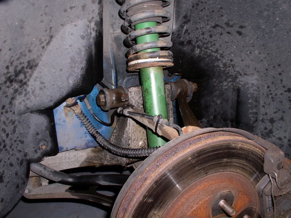

The observant will see the unrelated reason for examining this area on my 2001 XK8. The Upper Wishbone had at broken the front!

Originally Posted by GGG
”.......The observant will see the unrelated reason for examining this area on my 2001 XK8. The Upper Wishbone had at broken the front!
ouch !!!
was there an impact with a solid object to cause that freaky break ? What happened in the subsequent second ? Does the wheel / tire make contact with inner fender ?

Originally Posted by zray
ouch !!!
Z
That was the result of a pothole. The noise was like an explosion and remarkably the remaining arm of the wishbone supported the vehicle. The steering "kicked" but went back on course. Never seen one break before and hope I never do again.
From the position of the wishbone stub, it must have sheared at the top of the deflection. The fluid is where I'd sprayed release oil ready for dismantling.
One benefit - it was an easy disassembly of a fulcrum bolt!
