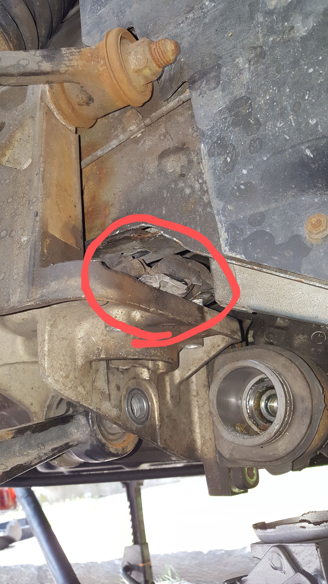

take a look under the car in the area of the rear subframe mounts. my car has over 200K miles and on inspection the Vee mounts were essentially flat. They are a bit of a pain in the butt to replace but well worth it. the effect on traming or tramelining (dont know the right word) was pretty dramatic. i think what was happening was that the flat-ness of the mount allowed slight but significant twisting between the actual frame/body above and the subframe below.
the problem area for me was that the original VEE mount was held in place with 4 #27 torqes bolts. Stripping and shearing, so be careful if you do need to go the VEE mount route. I replaced the torques with a hardened hex head bolt and good washer of the same size to replace the mounts.
There are steps that might be missing. sorry.
- maybe first see if you can get the torque bolts moving on the underside of the subframe before going toooooo far. i think one will be obstructed by the steering arms. I removed the arms for easier access to the underside rear subframe VEE mount bolts...
- remove the 4 13mm bolts from the steering rack, let it kinda hang there...
- undo the single 13mm bolt (I think they are) in the underside cone that holds the mount, sub and frame/body in place. its largely held by gravity (weight of the body of the car) and its a cone fit. not hard to deal with...
- remove both rear bolts from the X cross brace...
- I removed the lower motor mount bolts - holding the engine UP with one of those engine support bars. dont want the weight of tthe engine on the sub while changing the mounts.
- significantly loosen (but dont remove) the front subframe mount bolts after removing the brace thats in the way. reason for this is that you will kinda want to have the subframe sag rearwards so that you can slip the 2mounts into place in the rear of the subframe.
- if I remember right I THINK it helped to remove the bolts from the rear lower control arms (I cant say for sure) and you will see once ya get involved.
I hope this made some sense and might be useful...
Peace!
