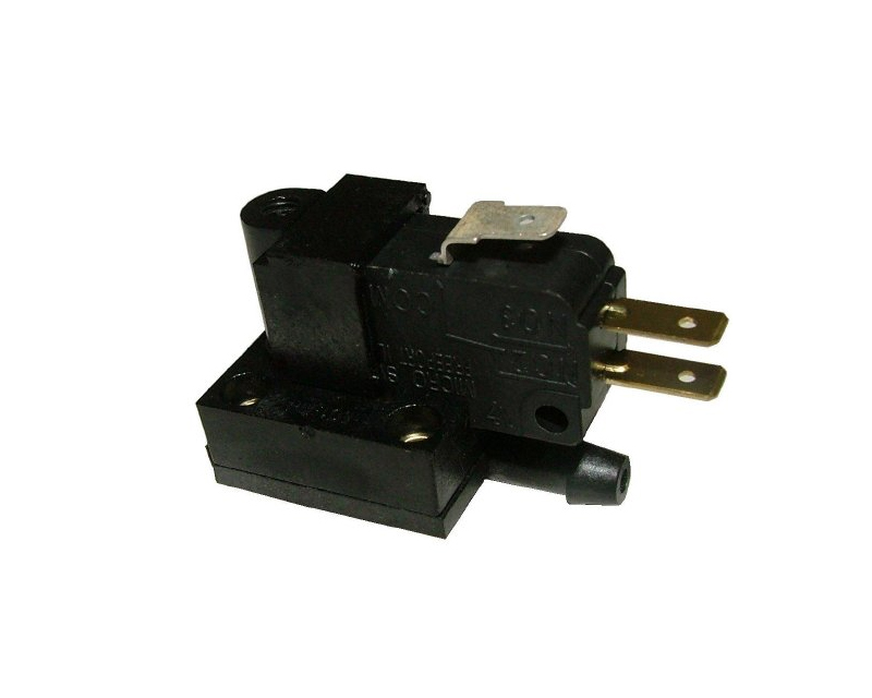

I'd like to know this as well; specifically what type of triggering mechanisms can be used to turn the fan on/off.

Lol,
1.Measure space on your inter cooler/not needed,I did the work (already done by me lol)
2.Buy a universal inter cooler fan off ebay(I chose 7") you can go bigger buts it more drain electrically, and not needed, they instal on the inter cooler with a plastic rod that slide through the inter cooler fins, and you get tabs that the rod goes into,which locks on them. Then trim excess rod left.
Universal 7" Electric Radiator Intercooler 12V Slim Cooling Fan Fitting Kit | eBay
3. Simply wire the little fan or fans to your main cooling fan at the radiator, as it loves to come on after and during boost and hot traffic lights
or
There are kits online you can buy, that uses a hobbs switch that detects boost and opens a circuit,I would use it for a relay(remote wire) and not run current through it to power than fan directly lol.
or a relay and have it running as long as the car is running, -that's my setup.
