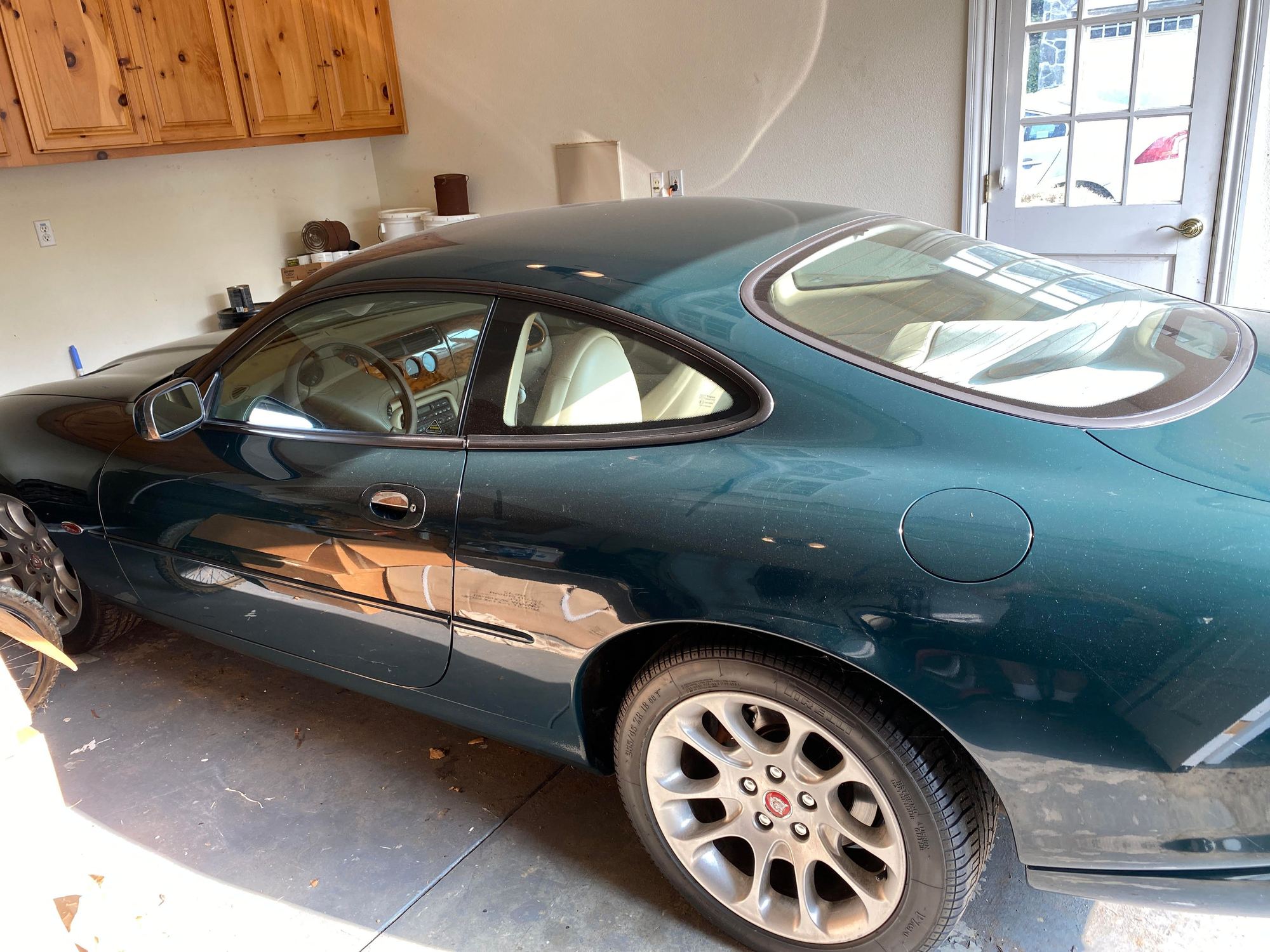

A friend has a 2000 XKR coupe he's owned from new. He wants to offload it, and claims to have a vague offer for $9K for it. It's only done 26k miles from new and is visually in mint condition. It's a very early chassis number (58?) and he's had a lot of issues on it over the years (incl new supercharger). It hasn't been driven in a while, but is garaged. Apparently, it's throwing codes, he remembers "reduced engine performance" being one of them. Question is, should I make him an offer for it? Anything above $9K would secure it, but I haven't even looked at Kelly blue book yet. Having just killed myself replacing all the coolant system pipes/hoses/pump etc in my wife's XF, I know what a beech these things are to work on.
He's disabled but is going to get AAA to put a battery in it, I intend to go over there with my OBD scanner and see what's going on once that happens.
It is a gorgeous BRG color and I would really like it, but have no idea if that is a good idea! Please advise!

Buy it fast, 26,000 mile one owner XKR for anything under $15,000 is a steal in my opinion. Even reasonable over that, and coupe is even rarer. I'm very jealous, enjoy!
edit: Obviously it'll need money but won't any XK8/XKR? It is so rare to see low mile cars like this and they never sell for prices this low. I think the blue book for my car is $2-4k, not really accurate from what I see near me. Even if you need to put a fair amount of money into it it'll be a incredibly rare find.

Take it for a test ride to the nearest Auto Zone and have the codes read. Come back and post them so we can advise what problems you are going to have to deal with. Low mileage doesn't equate to good condition. The cat likes being driven and coughs up hair ***** from sitting around the shed.

Unless he has documentation that shows the timing tensioners (and water pump) have been upgraded with the improved parts, then I would pass on the $9,000 offer. Those two items alone could cost you $5,000 to $7,000 to replace depending on any collateral damage caused when the timing chains let go.
to put in perspective, Nearly 3 years ago my ‘02 XKR cost me $7,900 and it had those 2 known issues already recently repaired, which cost the cars seller a cool $6,000,
So you see, you want to be the guy who owns the car after the repairs have been done, not the guy that paid $9,000, then are faced with a big repair bill.
I’m not a fan of low mileage cars that have spent more time sitting than driving. 50+ years in the transportation business has taught me that all cars deteriorate when not used. That goes double for cars that have
any extra level of complexity such as the XK’s.
