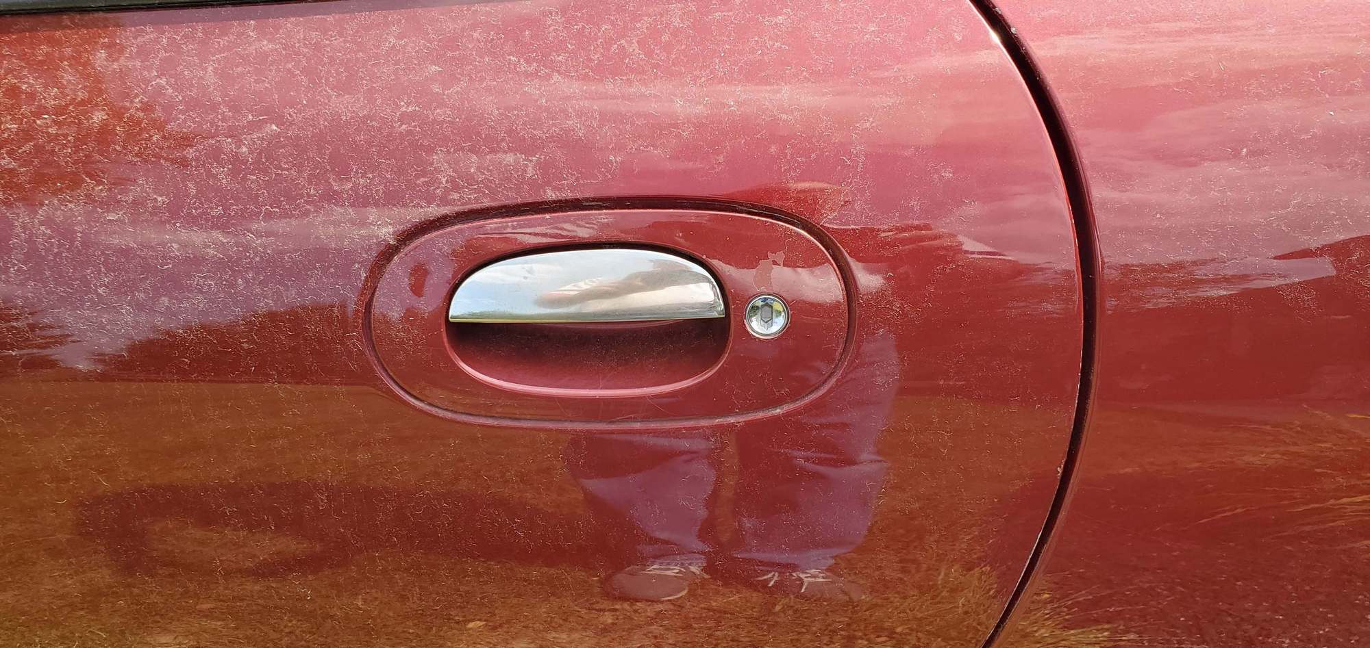

Just got the car home, 2001 XK8. How on earth do the doors lock from outside the car? I figured out how to do it from inside, but they won't lock from outside.
No button
No key fob
I've been reading the thread, some people are pushing buttons on the handle, key fobs, etc. Don't have any of that.
Old Jun 10, 2023 | 09:29 PM
dcarlo's Avatar
Joined: Sep 2017
Posts: 93
Likes: 55
From: S.E. Iowa
to lock the car from the outside, insert key into hole next to handle, turn left and it should lock both doors. Turn right to unlock. If you hold to the right, after unlock, the windows will go down, continue holding and the rear windows will lower, the top will unlock and open as long as you hold it there. If convertible top is fully operational. Hold key to the left and it will close the top.
