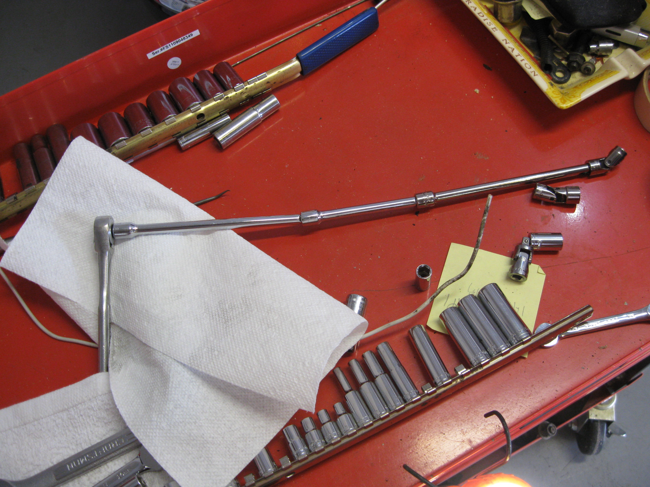

If I recall you can reach the bolts for the lines but you will need a few extensions. I think with the compressor in place you can get your hand to both “O” rings it might be a little difficult but it is a lot less aggravating than to drop the compressor.
I hope to add all of this to my how to.
Attached Thumbnails 2001 XK8 A/C compressor removal-img_2489.jpg   2001 XK8 A/C compressor removal-img_2485.jpg   2001 XK8 A/C compressor removal-img_2486.jpg
