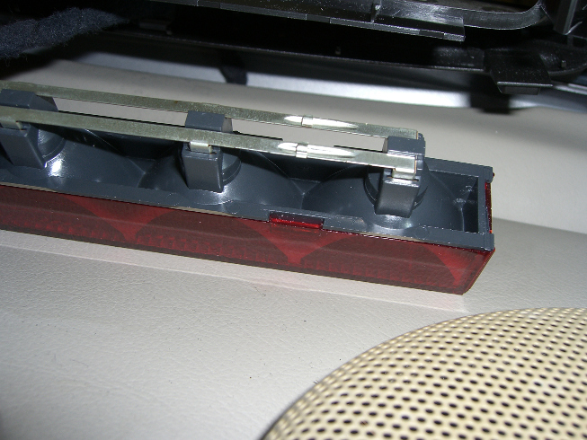

I am in the midst of replacing the bulbs.
From Jaguar Vehicle Care Handbook 5-16:
"High Mounted Stop Light . Bulb Renewal
Depress the two spring clips (A) at the base of the lamp cover (B)
and withdraw the cover. Remove the lamp module from the
base by releasing the spring clips at each end (C).
Remove the red lens from the bulb holder (D).
Taking care not to touch the reflective surfaces, remove the
bulb (E) from the holder and fit a new one of the correct type,
see page 5-18.
Fit the red lens to the bulb holder, fit the lamp module to the
base and replace the cover."
I easily removed the outer cover & lamp module with no damage. But, cannot see an easy way to remove the red lens from bulb holder. It looks somewhat brittle & begging for me to crack or break off pieces.
Also, I had tested to verify that 1 of the 5 bulbs was not lighting up & today b4 I started to disassemble, I took photos & all 5 light bulbs are now lighting up! So must be an intermittent problem with the bulb which probably is about to burn out.

Success! Using small screw driver GENTLY work way all around where red reflector abuts bulb holder.
When I took pix of brake light on to show 1 bulb off, all 5 old bulbs lit up! WTF?! Later, I took pix from front seat with (old) bulbs in holder pointed towards driver & again same 1 bulb was out. So, definitely one bulb was bad. New bulbs looked same as old ones & they all lit. Took picture of that b4 reassembling.
Was difficult to do the last step --replace “B” cover! Trick was to squeeze it a bit from top & bottom so it clicked into place. I actually used small mirror to see the bottom 2 clips which I had pushed in/up to release it.
Finally I took pics of brake lights on to compare to my earlier pics of lights on with old bulbs. Cannot see significant difference in brightness. Pic of old vs. New brake lights lit up will both show all 5 bulbs lit since it “decided” to work again as I mentioned. I will attach photos in the order I took them during this project.
Hope this helps others in the future.
