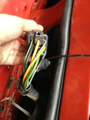

I then went for the cooling fan relay, the green lines are to the ecu and by back probing i was able to see the voltages to and from the relay,

I could see with my volt meter that the signal from the ecu was working as the volts dropped as the temp went up. On the relay it's self you have 8 pins with 7 populated,I noticed that the orange/yellow which connects to the left fan never got any voltage when the temp went up, the signal from the ecu should switch or pull up this wire to 12v to power on that fan, it should also pull down the green/orange wire to ground to power the other fan.
New relay fitted but still no fans, i used my power prode to manually turn the fans on, With a volt meter you can test the voltage at each fan, the left fan will have 2 grounds, and the right fan 2 12volts.With the relay unplugged you can give the orange/yellow wire 12 volt(powers left fan) and the orange/green wire ground (powers right fan).
So both fans worked but not being turned on by the car, even with the new relay and the A/C on still no fans. I then did the 100ohm resistance test on the ECT sensor, happy days fans a blaze.
