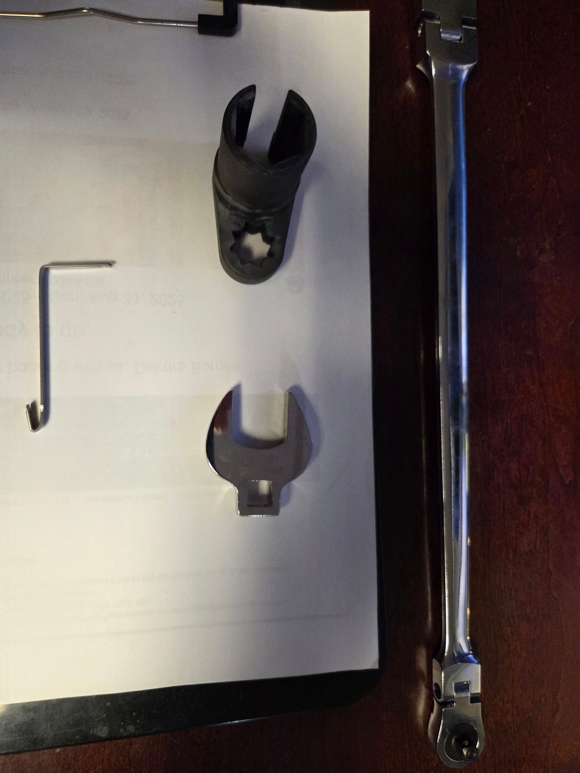

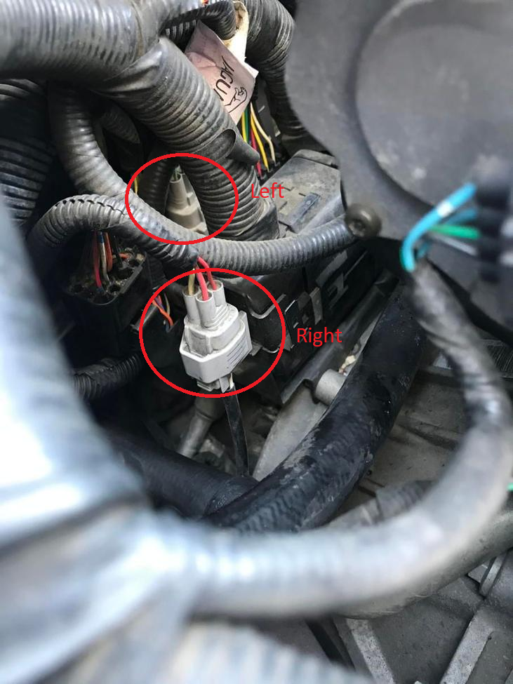

I did that PITA job recently, the O2s themselves aren’t so bad but the connectors can be a real nuisance.
The sensor plugs are light grey. The right bank is mounted on the junction box to the rear right of the throttle body, the left bank is mounted on a mounting panel in front of the firewall.
Unfortunately the sensor plug clips on to the mounting panels, so you can’t just unclip the connection, you have to dismount them from the mounting panels. The problem is that the mounting panel metal clip holding the connector points downward so you really need to unclip them from below.
You can try a small screwdriver from the top but be careful not to break the plastic O2 connector housing. I made a small release tool for this to get underneath the plug mounting panel and release the connectors.
Even so, they will test your patience.
For the O2 sensors I went in straight from the top with a split 22mm O2 sensor socket and 22mm crowfoot. HF sell a really handy slim long ratchet which is ideal for these tight spots.
The plug release tool is made from a strip of 4mm stainless bent to fit and with both ends sharpened on a grinder to slip under the connector plug mounting.
Finally – if you do break the O2 or harness connector then let me know, I have replacement male, female plugs and pins if you need them.
