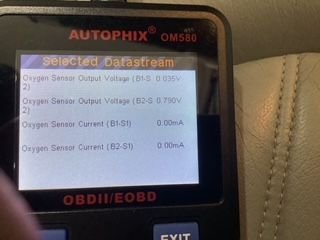

I do have some data stream capability if that would help. To me it looks like B1 S2 output voltage is too low causing the 1647 code and illuminating the cell?

DTC 1647 is Bank 2 (drivers side) upper sensor which is not what the data is showing? Am I looking at it wrong?

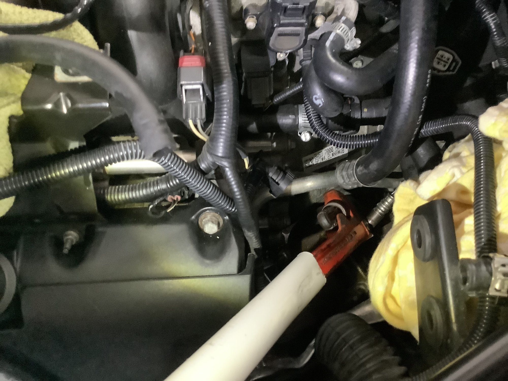

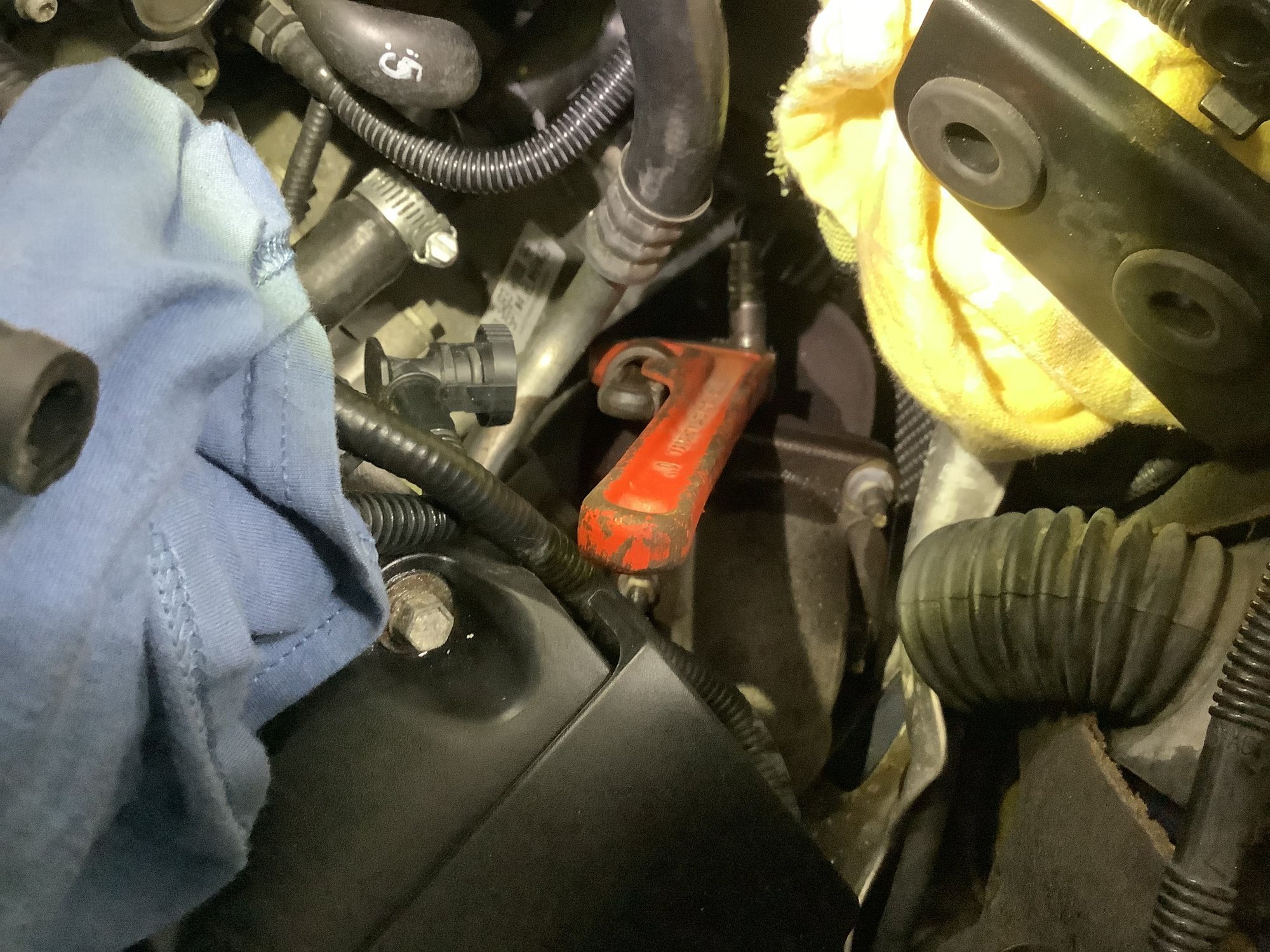

Well my sensor arrived and I got it installed same day. I decided to try getting out the old sensor with a pipe wrench because I was able to get a good grip on the flats and felt I would have a better chance of success than using a split socket O2 sensor tool.
Once a plumber always a plumber lol
Easy to get out with minimal damage to the sensor
When I installed the new sensor I used a little anti seize and torqued it in with an open end wrench which worked really well.
