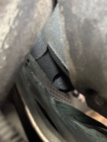

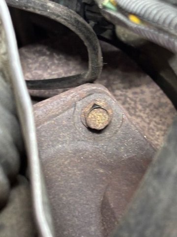

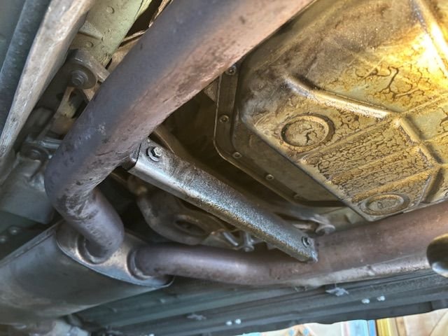

OK, here are the photos of what I think are the bolts that have to be removed to get the whole CAT out. Could someone let me know if I've found them all or if there's some magical, not easily seen or gotten to bolt that I'm missing.
This is one of the upper bolts This is the other upper bolt.

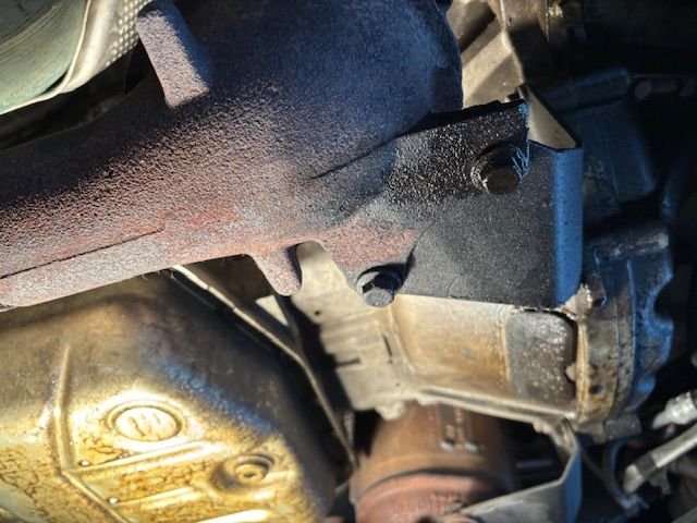

This is the bracket holding the CAT to the bolck. There are also 2 other bolts holding the bracket to the block that may have to come out.

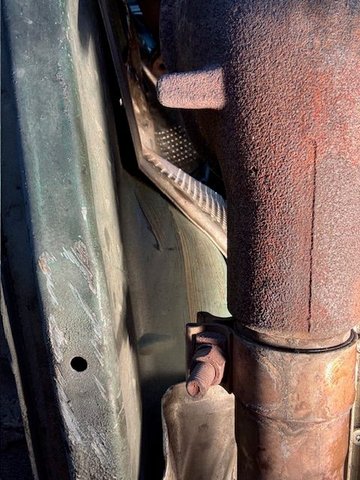

Im thinking these 2 bolts have to come off to lower the exhaust pipes enough so the CAT can be dropped
I'm thinking these 2 bolts have to come off to lower the exhaust pipes enough so the CAT can be dropped
This is the bolt that holds it to the exhaust pipe

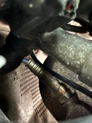

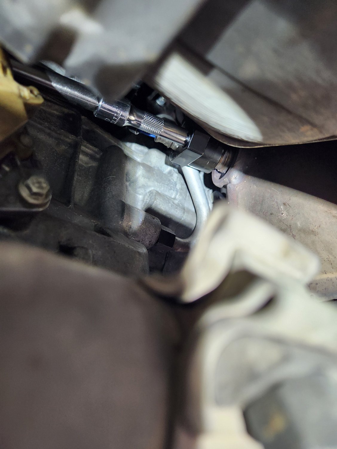

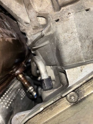

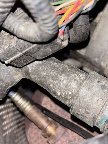

Downstream O2
Downstream O2
Downstream O2 - Another angle
Upstream O2
Upstream O2
Upstream O2
Upstream O2
I've tried from a couple different angles but I can't get any of the extensions into a position where I can put the breaker bar on them to get this thing off.
Looks like it's unbolting the Cat and the whole thing is going to come off. Grrrrrrrrrrrrrrrrrrrrrrrrrrrrrr

Aren't you just replacing the downstream sensors? If so, you just need a really long extension and a crow-foot O2 sensor socket. You come at them from back near the end of the trans tailshaft. Push the extension up to the sensor, put the crowfoot socket onto the extension, put the socket onto the sensor, put the ratchet onto the other end of the extension and give it a mighty pull. Once the sensor is loose you can remove the socket, etc., and turn it out by hand. Assembly is the reverse.
The left side of the car is a bit more difficult than the right owing to the trans shifter connector.
Old Apr 27, 2025 | 04:41 PM
OCJoeR's Avatar
Joined: Oct 2024
Posts: 455
Likes: 82
From: Orange County Califorina
That’s what I’m using. I can’t get the socket at a position where I can get the extension onto it. I’ll go back out later and try again but I’m not seeing any way to do it.
Old Apr 27, 2025 | 05:52 PM
Y2KJag's Avatar
Joined: Jun 2023
Posts: 683
Likes: 343
From: La Habra
I had a short "wobble" extension on the end of the much longer extension, which helped quite a bit. On the left side I was able to get a 7/8" wrench onto the sensor and turn it enough to get the socket onto it.
