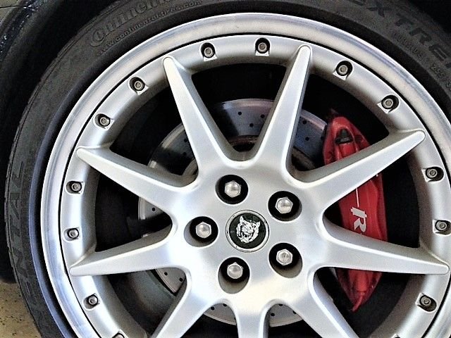

[img]
20" X 9" BBS "Montreal" Front Wheel
Hardy,
I'm attaching a Photo of my Left Front "Montreal" Wheel.....Let's see if it works????
Billy Clyde

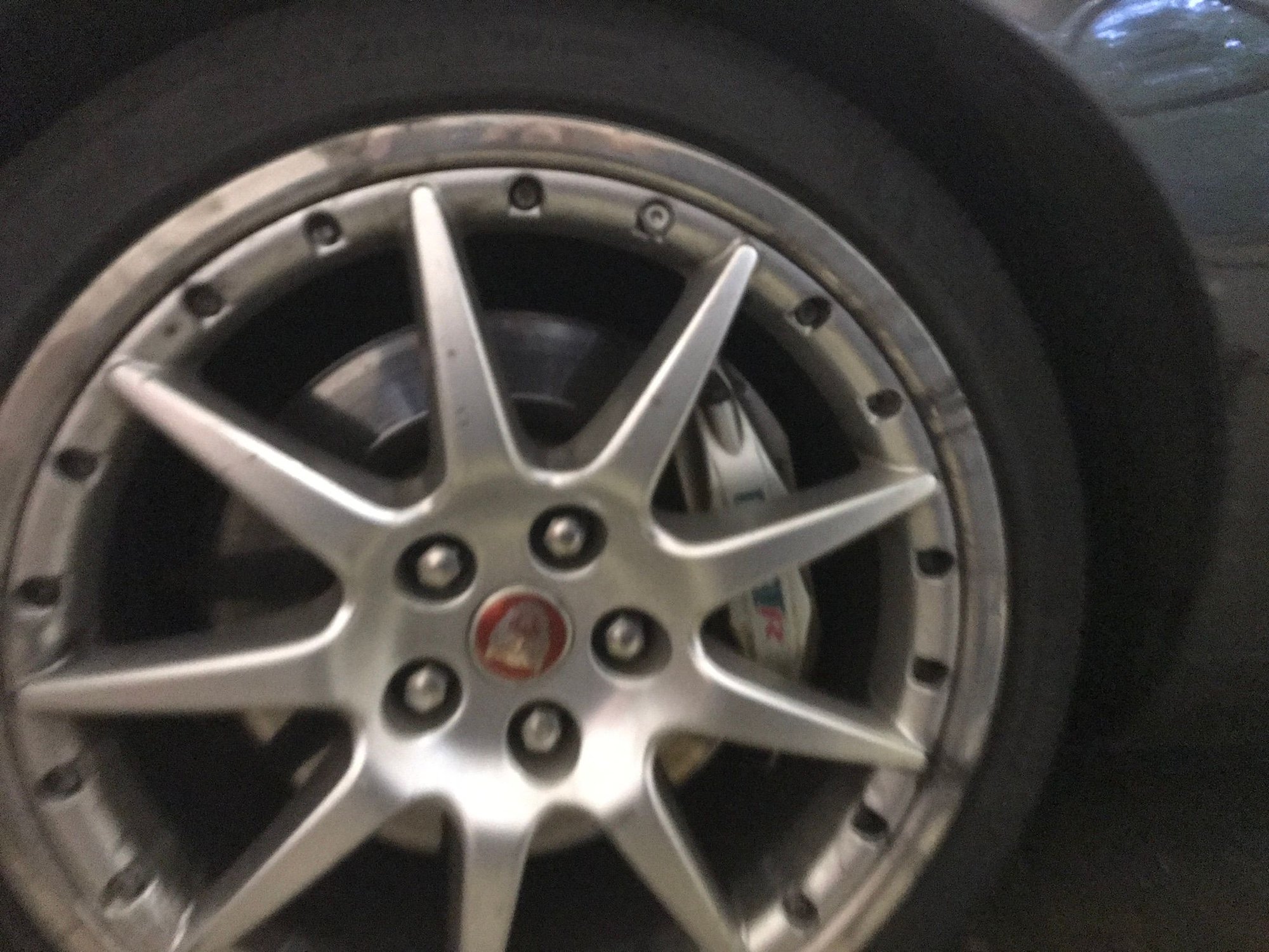

Here’s mine😊

Hardy,
Is this the Wheel that you are having the problem with? and what did you do to get it to work? Mine never would go through....
This wheel is the BBS "Montreal"!

That’s the bad one alright. Some of those bolts that hold it together were shearing off and some were backing out. The tire then loses air and there’s a danger of the darn thing coming apart on the open road.
What i I have done about it is talk to you
nice folks on here and beg for help. I’m going to call some of those leads you gave me and see if I can get a new/or used wheel also go down to Nashville and talki to some alloy wheel specialists down there. I’m still getting around in the car with a donut spare, but obviously that’s a stop gap.

Smile My left Front Wheel...20" BBS "Montreal"
Hardy, I've done this a 100 times but for the last week, I haven't been able to get it to work!!!! I'll try you directions now...Hopefully you will see my left Front Wheel...(Well! It worked this time......Thanks for the directions!)
By looking at your Wheel, it appears that the Wheel part must be bent or something like that....It just doesn't look smooth as this one below. That's really smart isn't it? I don't have any idea what cold have happened....maybe that's why the Guy before you sold it! After you get it repaired, you need to get a set of Jaguar Locking Nuts----You only need (4)!
Billy Clyde

Your wheel indeed looks much smoother, and altho I’ve had this car 9 years, what you say could be true, some of those sheared bolts looked like they’d been that way for a while - so said the tire guy.

In looking at the picture, the bolts don't look like the original bolts but its hard to tell. Keep in mind that only the hollow inflation bolt has anything to do with holding air in the tire. It is drilled through the wheel drum so the air will move in and out of the tire. All the others should not penetrate the wheel drum.
