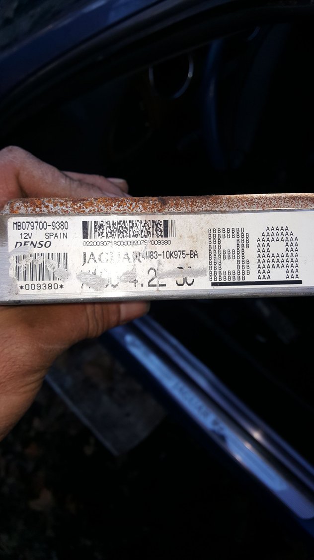

Are there more than one kind of ECM/U that can be found on MY 2003 XKR SC? I took a dive into seeing what might be possible with revival ofba 2003 XKR that got caught in a fresh water flood and did not find what I expected in that space under the panel on the RH side back by the fire wall...
Is the transmission module built into this type of unit?
This had a large single plug. Kinda single chubby rectangular ECU/M,,, as opposed to the flatter multiplug ECM/U that I see when doing searches for replacements.
It did not look good,,, like it's seen water. Inside was spotless, tho.

Jay,
That's correct for the 2003 on.
I think the TCM is inside the trans.
If water hasn't got inside you may be lucky, but I'd lift the PCB out and take a look at the underside.

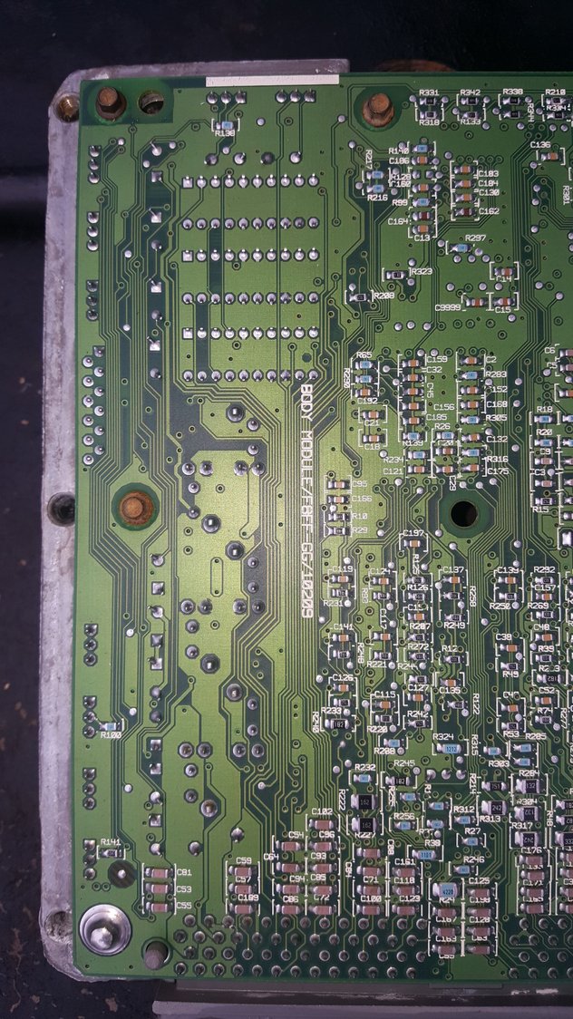

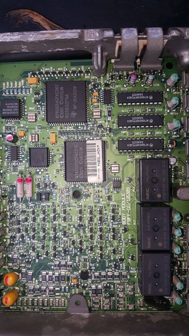

Below are photos of the Body Control Processor. Looks clean to me...

BPM looks OK to me.
