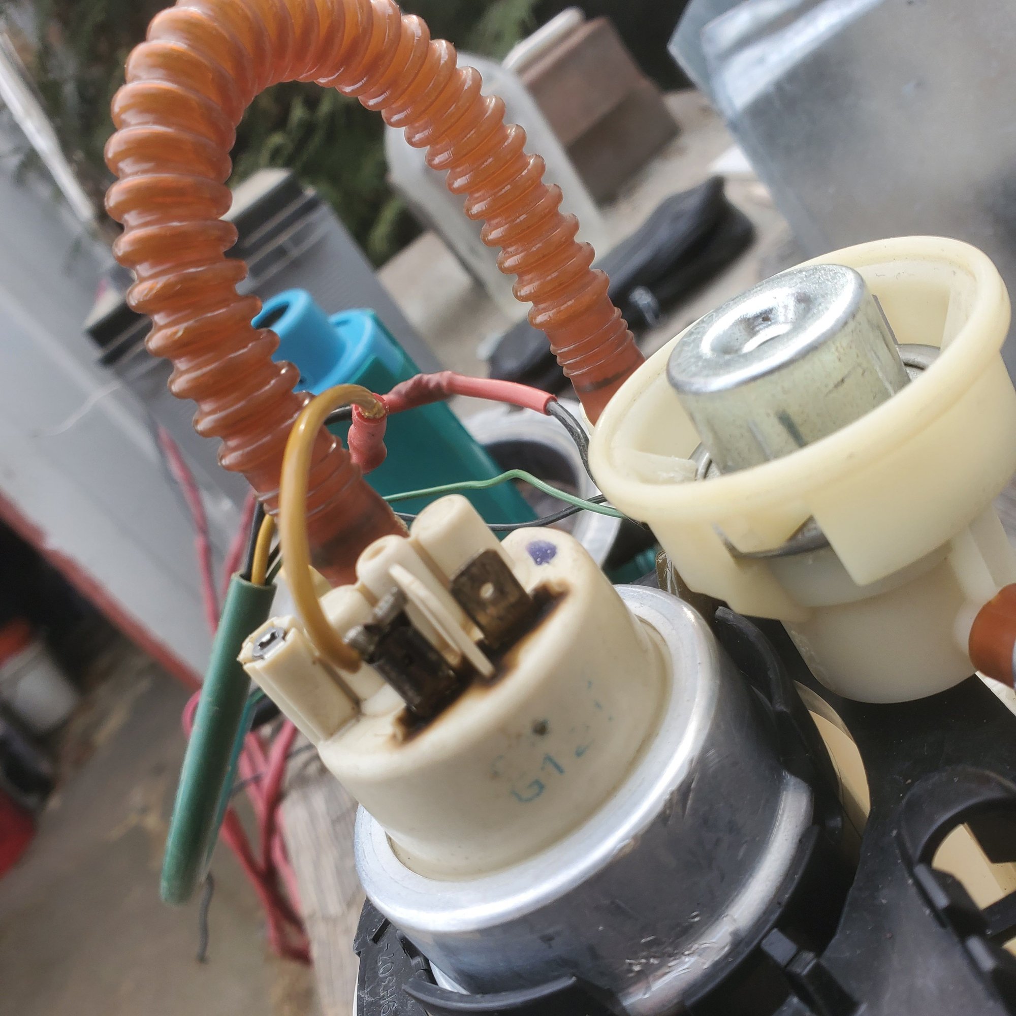

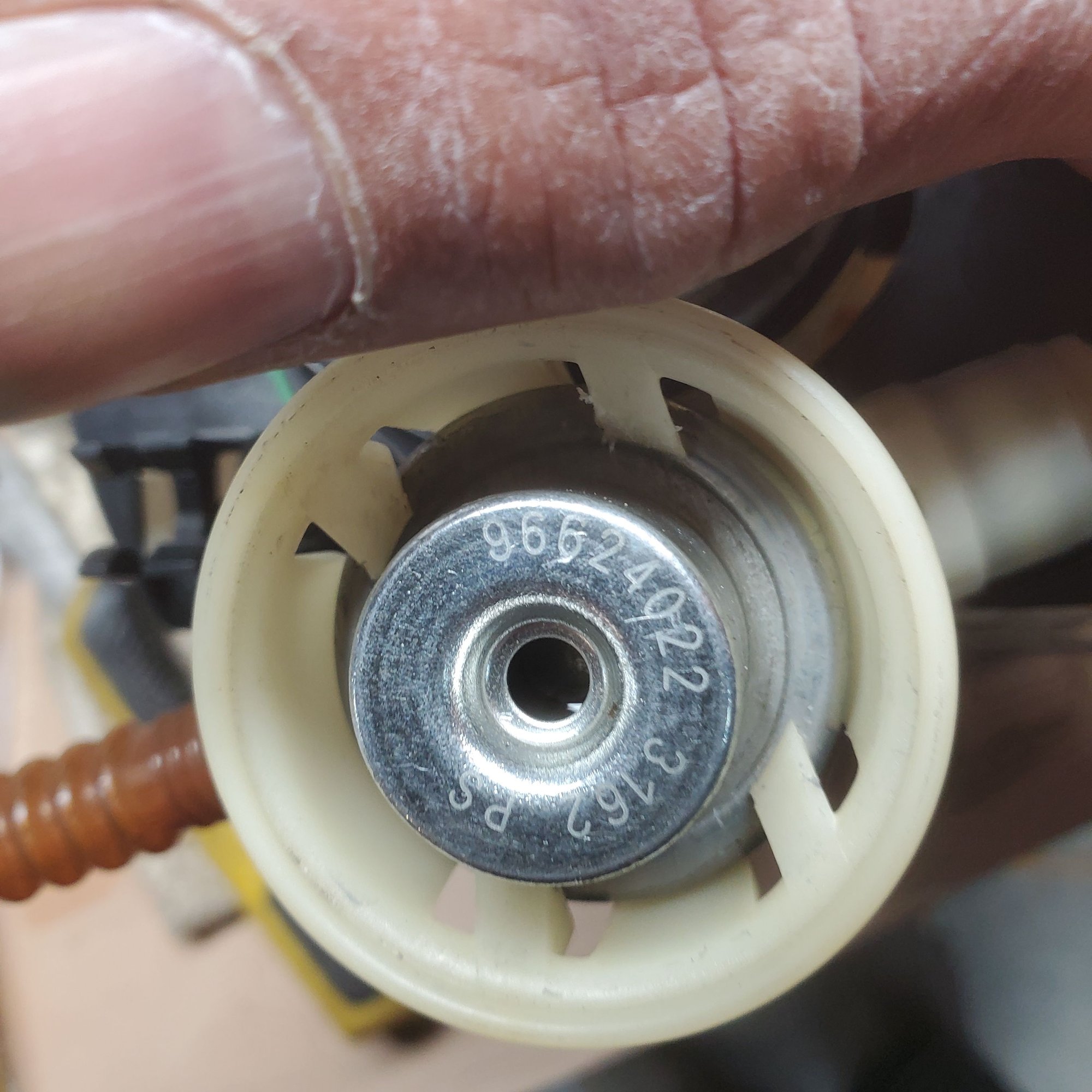

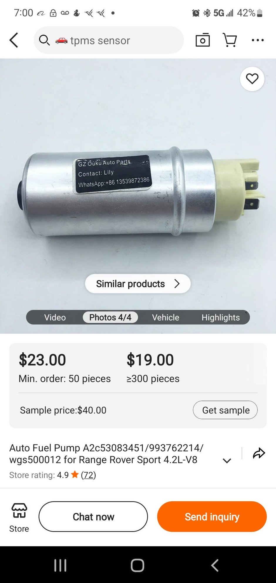

I'm seeing this. Could it be? It looks exactly like the OE pump in the basket... I have a hard time remembering how I came across it, but I think it might be right.
Some of y'all are better at researching but I hope this helps someone down the road. I would love to hear y'all's thoughts.

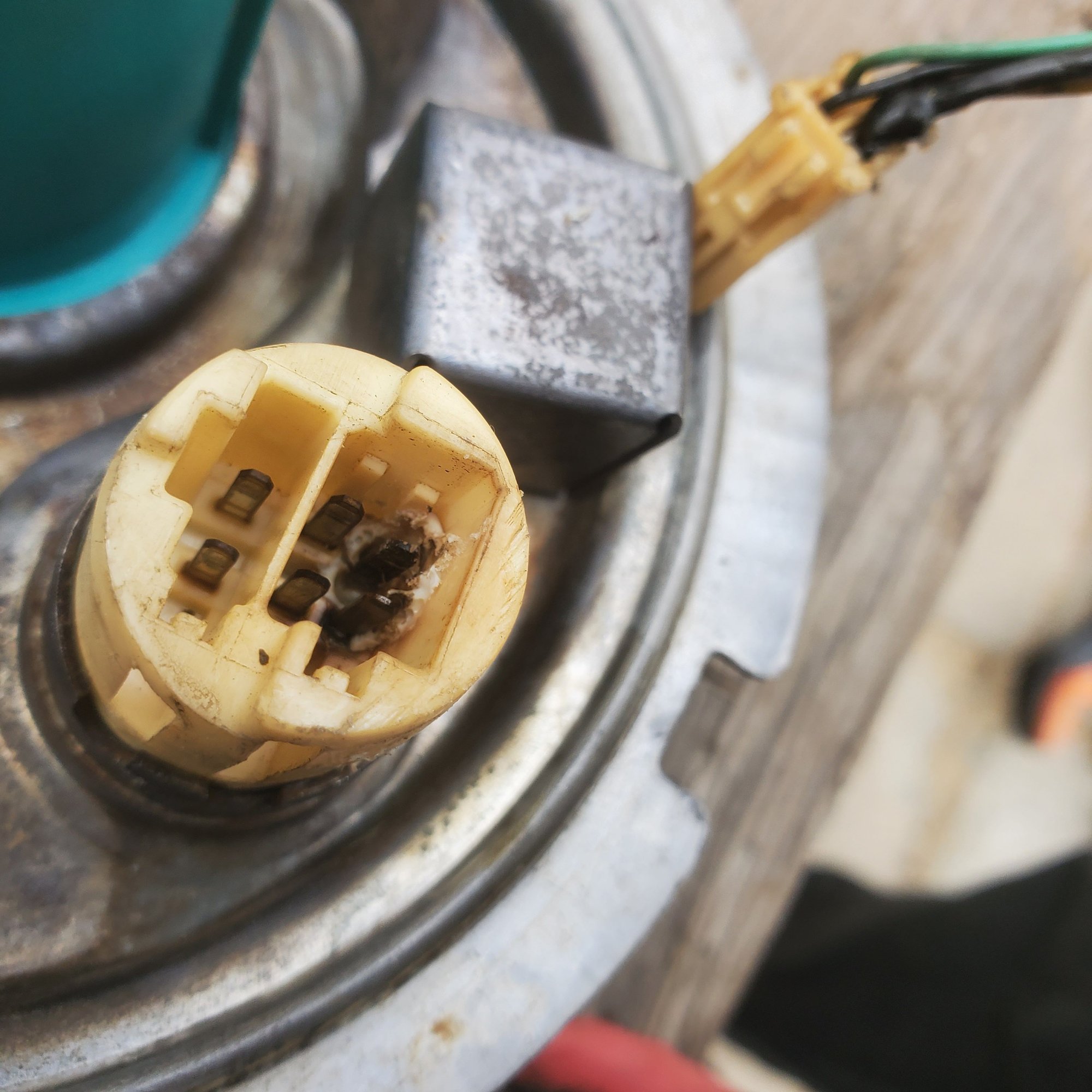

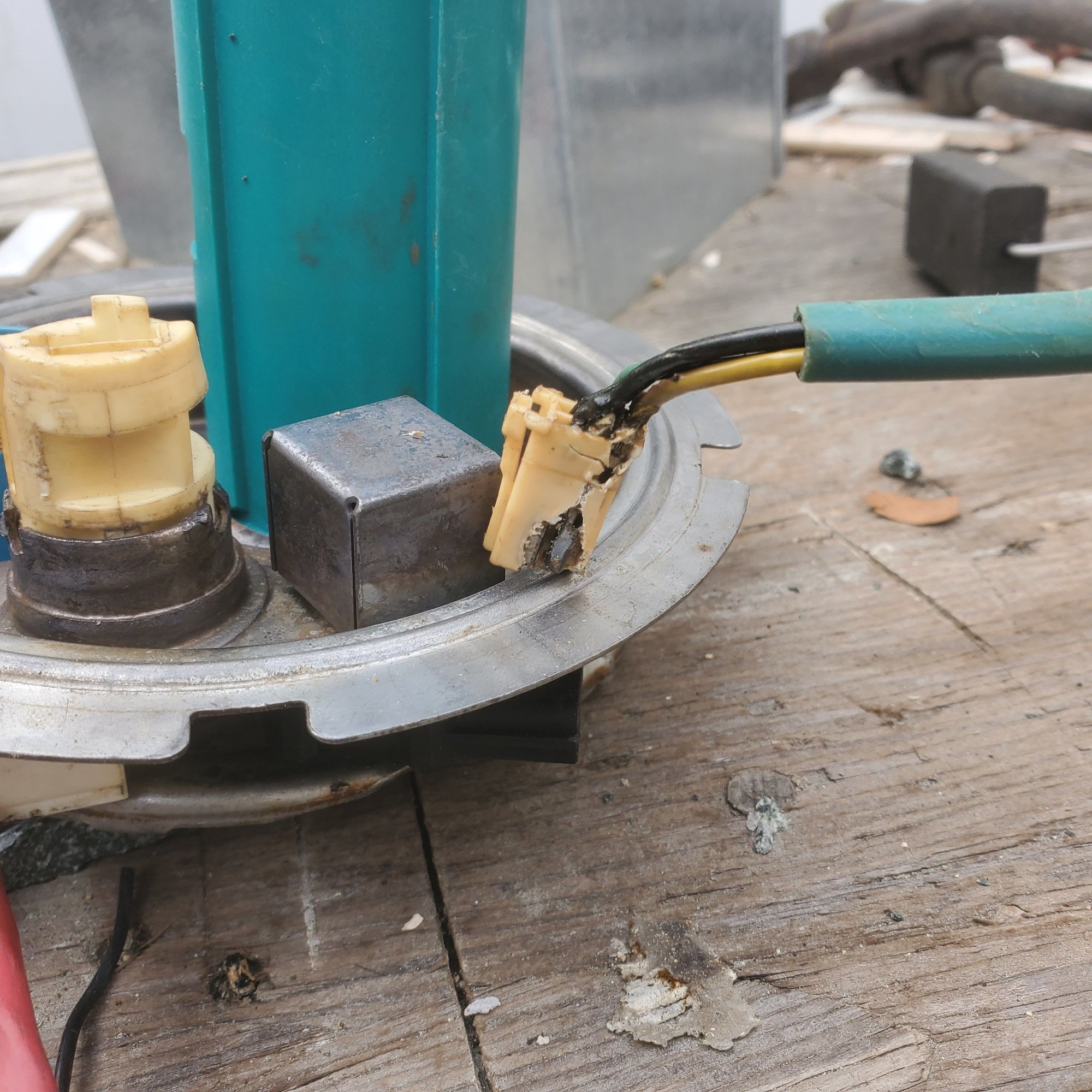

As for mine. Scary thing thinking this was in the TANK! See pics. I cleaned up the contacts on the pump and applied 12v. Pump fired up ran quietly and steady. From back in the days of rescuing this car (this is the car that took a swim in the lake) I actually had spare plug parts. Nutty. I'll have to get it back in the car but it's just been to cold here and I've been ill. We shall see.

Absolutely.... The plastic pump housing can be opened and disassembled. Everything inside is accessible and take-apart-able... From there there are 2 large clips that (if you look at the photos above) grab that small "bump" in the steel/aluminum cylindrical casing of the pump body, to hold it in place. It's a tuckass clincher for fear of cracking the the tabs, but what you have to kinda do is pry the two large tabs back and pull the pump out of the top section of the plastic assembly. If a pump can't be found that has the small raised "bump" on the body like the OE, it would be as simple as using a heavy duty zip tie and securing the pump body to the plastic housing - no big deal. The question is, which pump? For me, its not so much about the size and it fitting into the plastic house,,, its about GPM and pressures and proper responsiveness to the PWM pulses being sent by the fueling regulator. Seems like any pump that IS a PWM pump or comes from a PWM return-less system, that has the capacity to pump 255LPM (I think it is) should work, NO? I've just been a coward about it.

I am SORRY that I did not take measurements of the pump and post them in my last post. I have to get back in there and will.... One, thing was that the housing seemed cold and brittle and I didn't want to risk cracking the tabs. But I will,,, Ill go back and get the measurements and post them.
I have a real feeling that that pump ($40!!!!) above is the correct pump but I'm (ashamed to say) I cannot afford the cost a the moment. Money is going in other directions.

Again. About the pump linked and imaged above the VDO WGS500012 (google search) it comes up for a lot of jag/range rover 4.2 liter supercharged models. looks like a fairly common pump for several high-end-ish style cars. Thing is they rarely seem to come separate,,, as in not installed in a basket specific to certain make or model vehicle. I went ahead and ordered one ($40US) form the Alibaba site. We shall see. Thankfully, I can have the pump IN and OUT in minutes due to the access hole I have in my back dash. From what I can see and in the little bit of reading, it seems like it could be the identical pump. I'll tak 40$ all day, and just reuse the basket. I also would like to get some better ideas about the pop valve/pressure regulator in case that would ever need replacing... When I got this car the pop valve/pressure regulator was shot. I thankfully got another one form a member here. Seems like a million years ago now...
