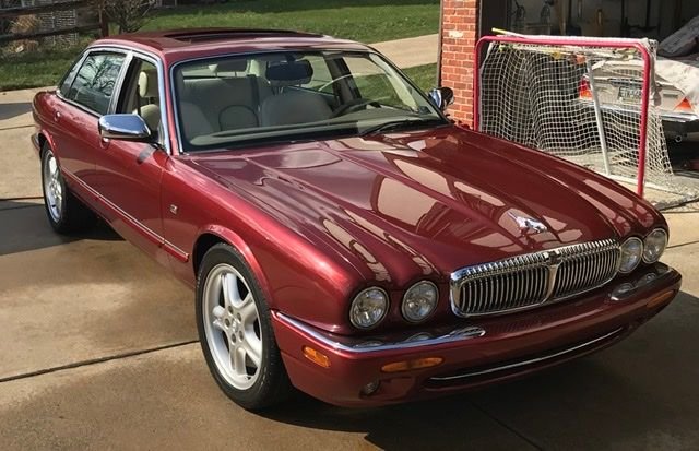

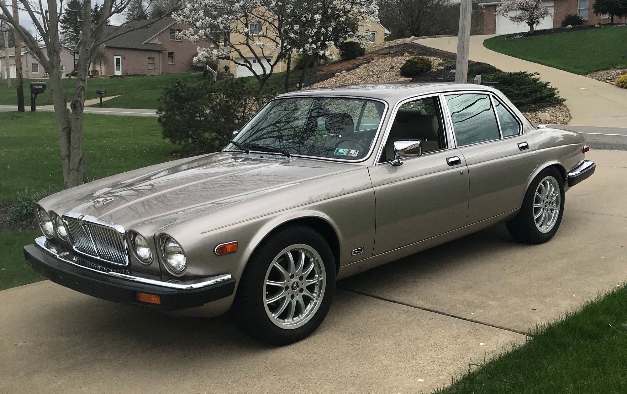

I have always loved Jags since I first saw one back in the early 80s when I was 13. I said to my parents that I am going to buy one when I get older. They were like “ya whatever”. I am now on number #4
Here we are on #2
1987 XJ6 18,000 original miles
1998 VDP XJ8 45,000 miles
2005 XKR 4.2 34,000 miles
