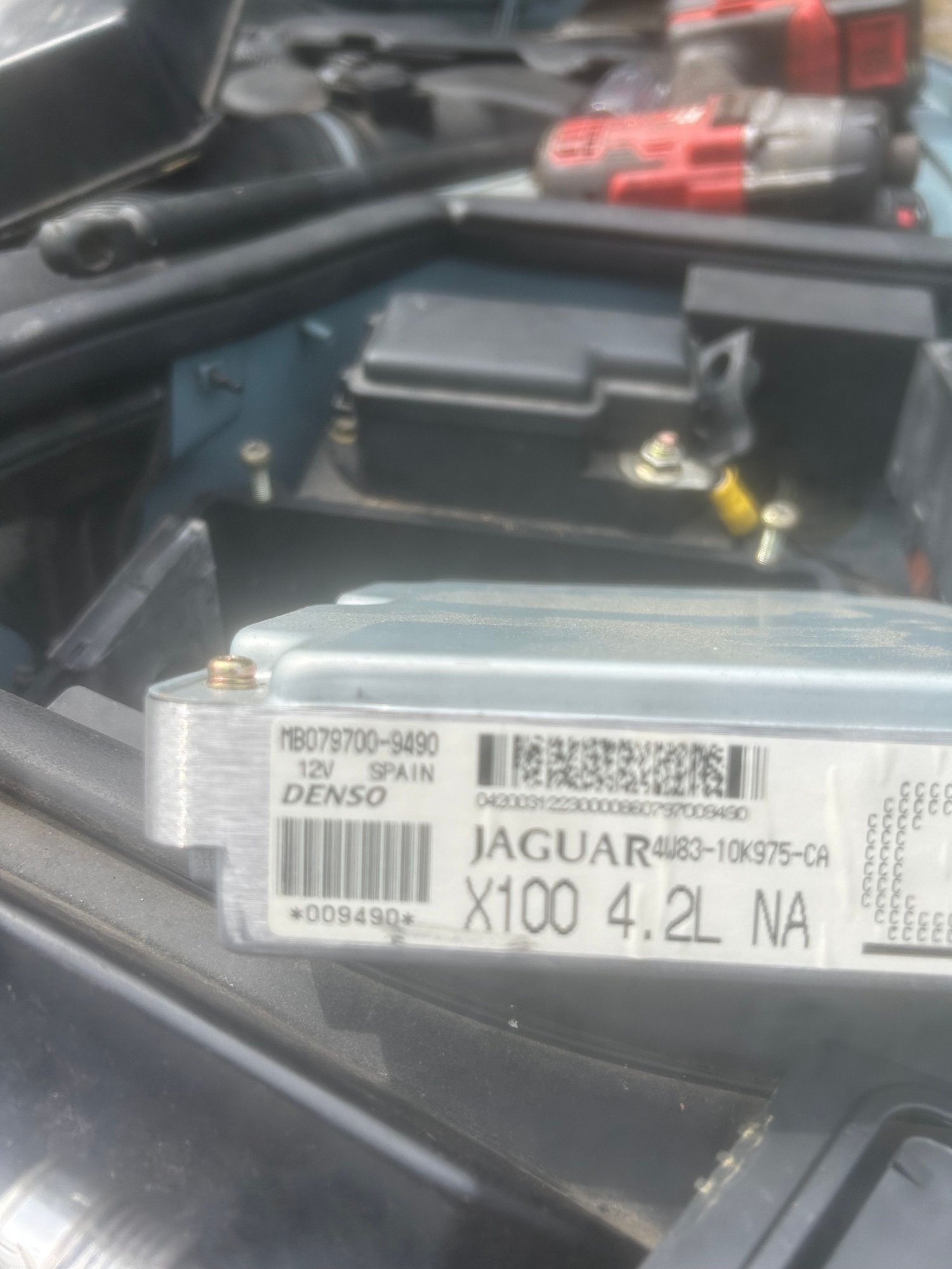

My cross pipe had a hole in it so I replaced that while I was doing that I replaced the plastic fend water pump. There was no issue with it. All the fence were intact. Shut it down normally went to start it and I got a crank no start all fuses Battery was showing 12.3 relatively new battery Attached are some codes
please if anyone can help that would be much appreciated.
these are the error codes that came up for my 2005 XK84.2
