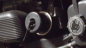

In earlier cars I'd point you right to the vacuum line connected to the throttle body. That was changed long b4 2006, but ?, maybe it'll help? Wth ez enough to check vacuum lines.

A photo or diagram of these vacuum lines might be of help to me in the future.

P, this is the hose I referred to. My motor mounts wore, engine moved (a lot), would disco this hose. All ok until cc tried to accelerate. Nothing happened, cc disabled, restricted performance on dash.
