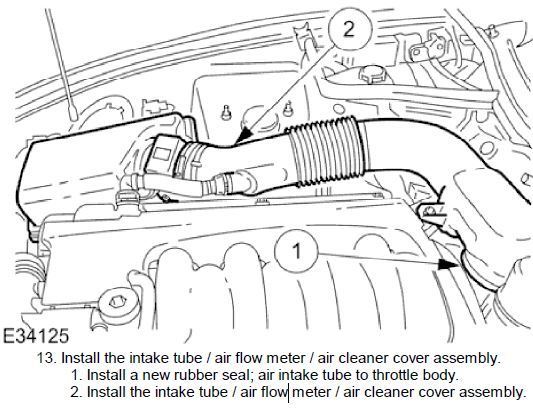

Need to make a correction: Jaguar does not use the term "MAF", uses air flow sensor. In all my posts above, MAF is really the air flow sensor.
And after several days of checking, now getting both P0171 & P0174 every time, decided to replace the air flow sensor. Ordered an aftermarket one from SNG Barrett as it was in stock and less than half the cost of an OEM one.
Prior to replacing the air flow sensor, I wrapped some Teflon pipe tape around the O ring area of the air flow sensor to make a better seal; just in case this was the air leak. Still got the same two codes, so I went ahead and replaced the air flow sensor. I did a hard reset and then started the engine, monitoring fuel trims saw both banks were below 10% for both short and long term. Have not seen those levels since I started this.
Took out for a 30 mile drive and all was good, no CEL, no Restricted Performance. Returned home, got the scanner going and once again the fuel trims all look great.
Not calling this fixed just yet, need more miles, start/stops before I do that.

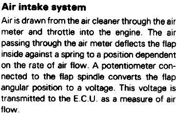

Hi Lanny,
Congratulations on your resolution of the lean codes!
In Jaguar service documentation, the terms Mass Air Flow Sensor (MAFS or MAF Sensor), Mass Air Flow Meter (MAFM), Air Flow Meter (AFM), Air Meter (AM) and Air Flow Sensor (AFS) are used interchangeably. You will also find references to the "hot wire sensor" or "hot wire probe," which also refers to the MAFS. Here are just a few examples from X100 Workshop Manuals and parts.jaguarlandroverclassic.com:
Cheers,
Don
When I went looking for a replacement MAF / air flow sensor, I did not get much using MAF, but I did when I used air flow sensor....IDK???
Most parts suppliers list them as Mass Air Flow Sensors, not MAF Sensor or MAFS, which is probably why your search string of "...air flow sensor" was more successful.
Cheers,
Don
