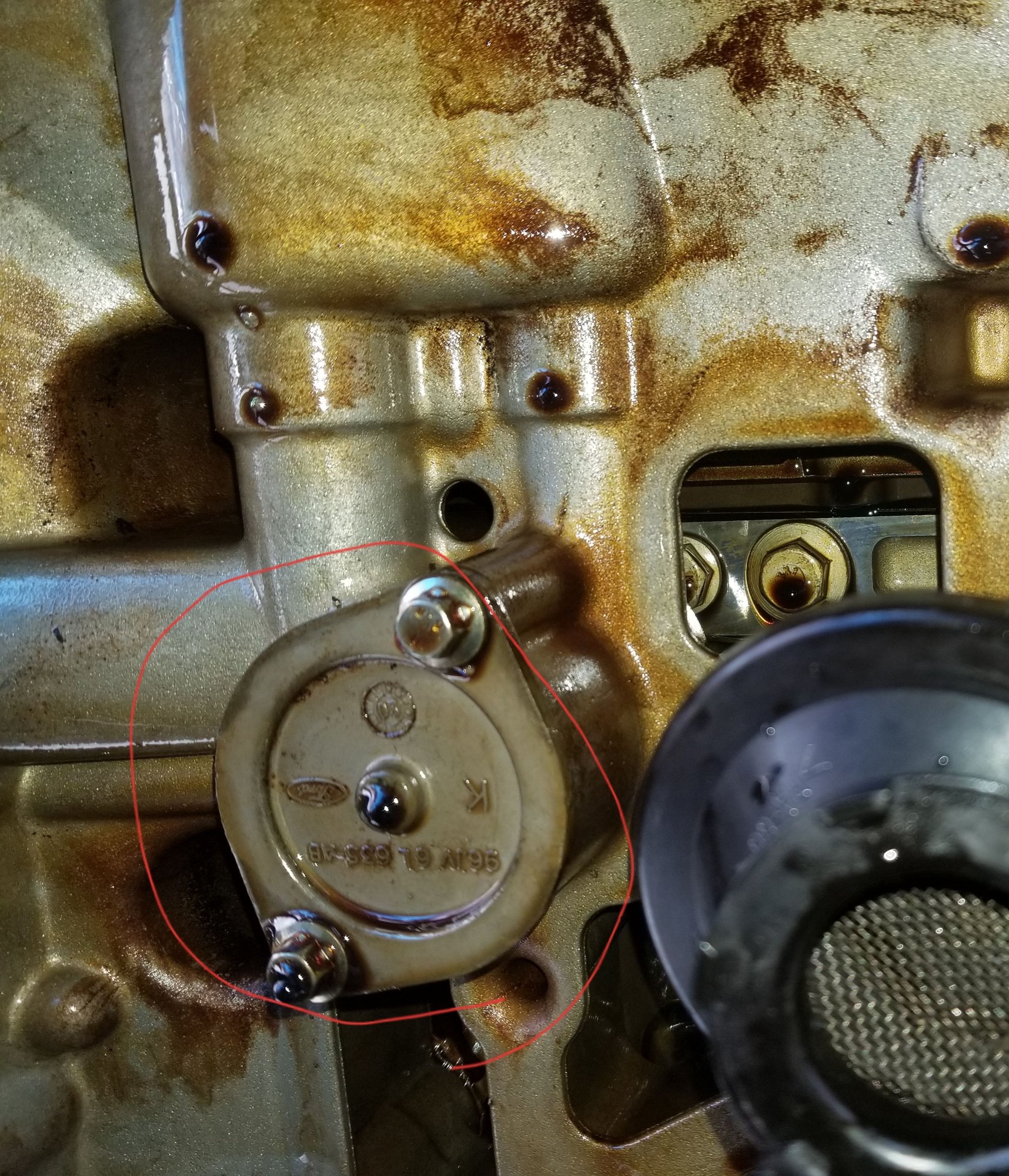

Out of curiosity (killed the cat),,, does anyone know what is behind this door???
Likely something you should not be getting into.....
Perhaps a spare bolt for the oil pick-up.
Is that the oil diverter valve for the oil cooler? To be sure you could snap those bolts off and have a look.
Hahaha - be par for the course! I ain't gunna open it,,, will probably go on a diagram dive... My Porsche has an oil thermostat... Cool little thing...

Originally Posted by drmike
Post #27 on this thread?
Awesome DrMike... Thanks.
Again,,, curiosity...
Now I'm wondering, are they a wear item...?
I'll be looking around as well.

Actually,,, looking more closely, it must be an important bit. I wonder if it works like a thermostat? And if so, if it fails does it fail open or closed? Could it be that many of us are driving around and the oil cooling system hasn't been operational for years with no oil going to the cooler OR,,, is it that the valve is stuck in a way that is only bypassing to the cooler...?
