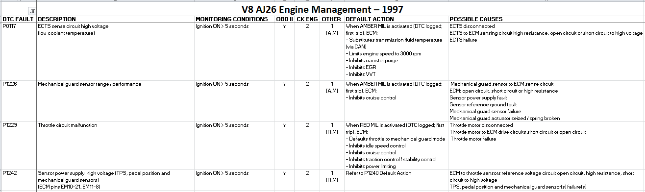

The codes I'm getting are p0117, p1000, p1226, p1229 and p1242.
Here is a snip from the Jaguar 97 DTC list for those codes:
I have not included P1000 as that means that the car hasn't completed its emissions diagnostics yet. That will change to a P1111 once the car is happy, so can be ignored for now.
P0117 may be simply that the engine coolant temperature sensor is disconnected (the connector has a plastic tang that breaks off allowing it to come apart), or the wiring has an issue.
The other three P-codes could be ECM-related, but you've had it repaired & also see the same codes with a replacement module?
I would start with point-to-point wiring checks between the ECM and the throttle body.
Note the TPS on the early cars is an electronic rather than mechanical device. I've not read of any true failures, unlike later cars (post-98).
What gauges have you replaced & do you have cruise control?
edit: P1240 default action is the same as P1229

It was getting rather late when I posted last night (too hot=couldn't sleep), so I've done a little digging in the EG this morning.
Interestingly, it states this:
So, the MAFS (it says IATS, shows MAFS on the diagram), coolant temp sensor & all the throttle sensors share a common ground, supplied by the ECM.
Also, all the throttle sensors share a common 5V reference supplied by the ECM.
I'd definitely investigate the wiring around both of these.
