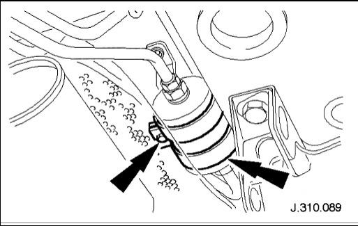

Kneel down at the door on the left of the car facing forward and take your right hand and reach under the car just behind the door and you will find it. If I recall that a fuel line separation tool is not the case on you’re my car.

99 Jag XK8 Conv. Where exactly is fuel filter located? I've seen reply's of: left rear wheel, under the back seat, by the fuel rail. Anybody change one?
Old May 23, 2012 | 05:58 PM
Likes: 17,009
Mike,
Looks like you didn't read through this thread before posting the question.
1. where exactly is fuel filter located? - see Posts 2 and 3
2. see Post 4 for the tools required
3. see Post 5 for safety advice and money saving tips
It's easiest to reach if you take off the left rear wheel. Then look for the fuel lines which run just below the bump-stop for the suspension. Follow those fuel lines forward, inboard from the wheel well and you'll see the fuel filter right there, partially hidden by a silvery corrugated heat shield.

Filter is to the left of the exhaust heat shield:

Meet us half way get under the car and look for it. It is on the drivers side between the drivers door and the rear wheel as shown in the photo on post #3 & #12. This is a compact car with a lot of stuff added in places you would never expect. Expect the unexpected and good luck.
