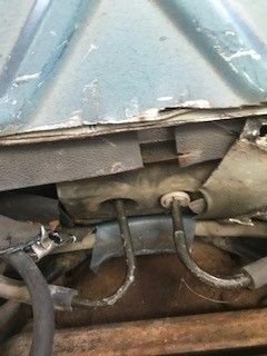

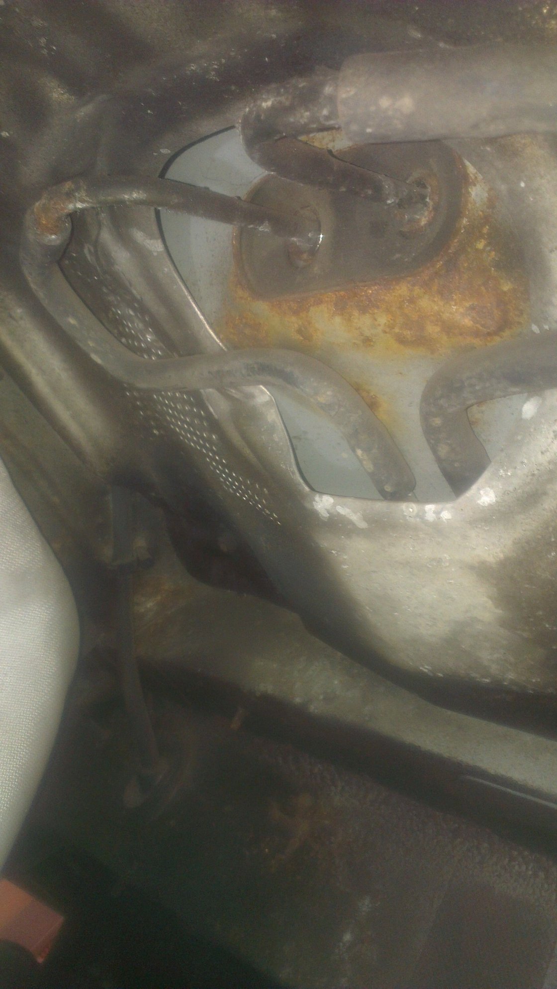

The hole that owners of the convertible cut is for direct access to the top of the fuel tank, with the hole cut you can change the pump/pumps with out having to remove the flow and return fuel lines from under the fuel tank with the disconnect tool, also you dont need to remove other things to move the tank in to the boot.
I have a coupe, so i use the sub woofer hole to change the pump/pumps (no need to disconnect flow/return pipes)
if i had a convertible i would cut the hole and not bother with the flow/return pipe disconnect,.. others would NOT cut the hole...(your car you choose)
Unfortunately for thenas007 (thread starter) he didnt cut the hole and decided to remove the flow/return pipes with the disconnect method.
As far as i know, there is no way to cut a hole to help with the disconnect of the flow/return fuel pipes.
Above photo is of the flow/return pipes that you need to disconnect if you dont cut the hole to change the pump/pumps
Hope all that makes sense and helps in some way.

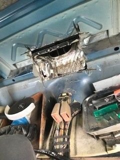

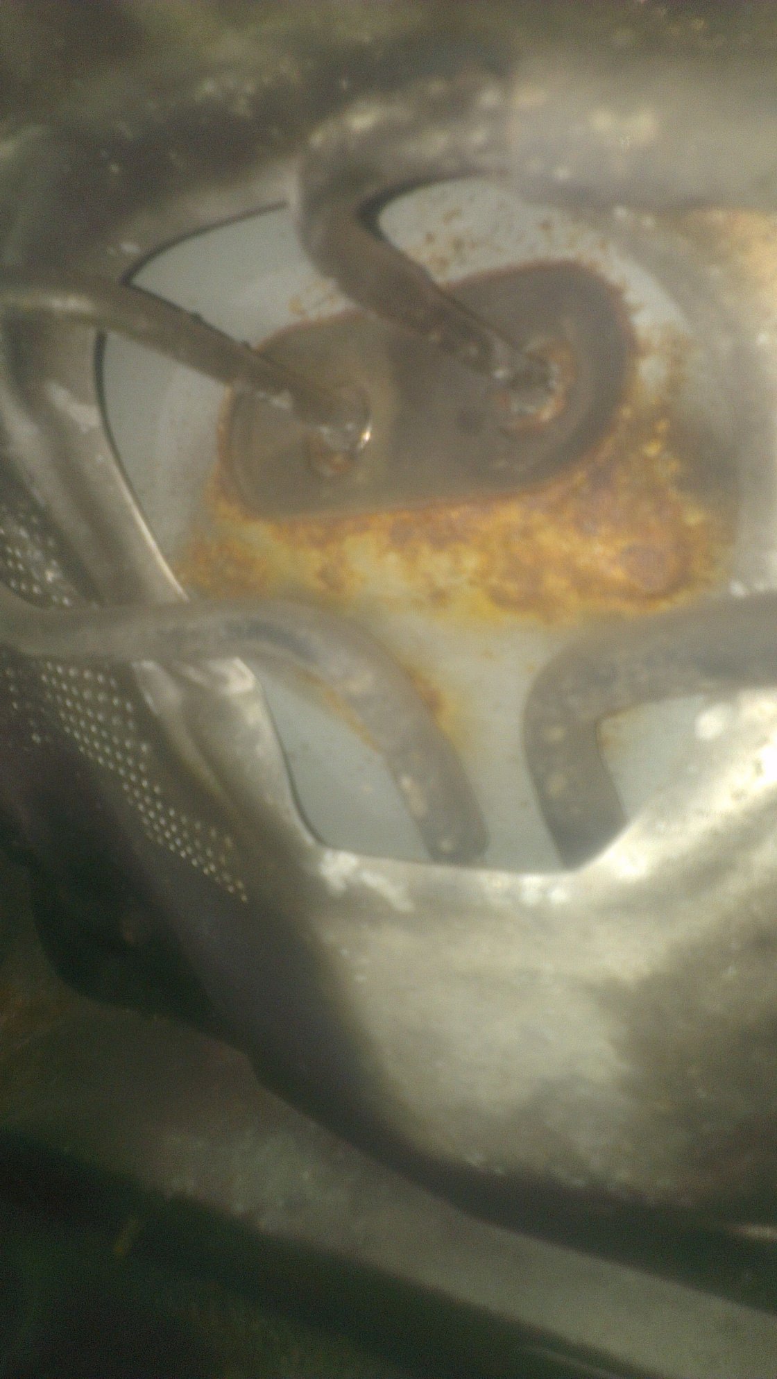

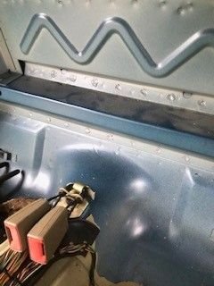

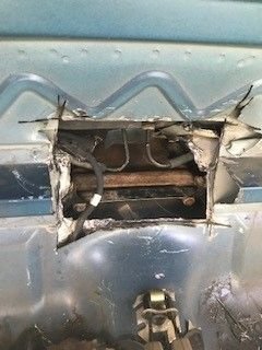

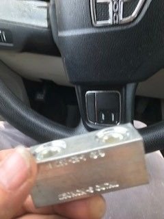

I was under the car for 3 days, trying multiple methods. I am an engineer and decided that if I cause damage cutting access to the fuel line disconnects I will fix it.
Completely emptied the tank and blew out area with compressed air, left fan blowing on the area overnight then stuffed a wet rag in by the fuel line connections.
There is a double wall of metal plus two fairly weak cross car braces and a heat shield. After getting half done with a 4.5 " HF cutoff wheel (4 discs) I went to the 6" 11 amp wheel.
Cobbled her up good but I will make a pretty thick sheet metal cover and cross car brace when through. I know I just compromised my protection from lots of bad things and need to fix it.
There is a huge 3/0 battery cable clipped just above and left of the tranny tunnel you will hit. Of course you disconnected the battery.
There is not a lot of space in a jag back seat - I was actually more sore after a couple of hours of cutting than all that time under the car.
Cut off tools are very dangerous! They throw tons of fire starting sparks. You need to be fully clothed with gloves and face shield - you can lose a finger in a split second - they can buck like crazy. Protect yourself!! Protect the interior of your car!
Pull your tank a couple inches out toward the back or you may cut your fuel lines.
Please don't attempt this. I had fixed my pump and reinstalled and the connections leaked, wouldn't budge, Then I invested 14 more hours before I gave up and went invasive. Mostly because I couldn't face doing it a third or fourth time from beneath the car.
$2443 and a month wait at my dealer. $1500 and 2 weeks wait at the Indy who would have very limited experience if he ran into the problems I did.
Cable requires a 3/0 Copper to Aluminum butt splice - you won't find it on google but a good electrical supply will have. Must be CUTAL (Copper to Aluminum) compatible and get the screws not the crimp model $20.
First observation is the fuel tank may sit with the fuel lines pressed against the firewall. I may have had better luck if I pulled the tank out an inch and created room for the lines to back out. I was on my back under the car with a one inch by 4 inch opening (propped up from the differential and jack stands on the sides. If I went to just jack stands I would lose a couple inches of height because the jack would have to raise the car to remove the jackstands. 16" locking pliers would not reach or turn or do anything once in the hole. 18 ' angled pliers could kind of be hooked around the gas line loop and pulled but interfered with the space needed for the disconnect. I dont think trying to grab the lines to more positively work the disconnect is possible without more access, and may cobble the lines. Experienced people must drop the suspension for more underneath access.
The other issue is I may have to do this a couple more times to be sure it doesn't leak - previously didn't leak with 5 gallons and then did after I filled up - that was dangerous!
I will try the disconnects with the improved access this evening. I have new stuffer pins and seals coming this weekend if necessary.

OK. Once I could access and get both hands on the disconnect and fuel line it still took a few minutes each to disconnect.
The lines were a little bent but not too bad. One of the four retaining tynes was a little flat in each of the stuffer pins I pried it up even with the others.
I was a little daunted by replacing the stuffer pins. Getting all the tiny seals out of each and the new ones back in place looked possible but tricky. I was of the opinion my problem was the tynes, and now that they were even (and I had quick access if they were not) I would give them a try. Even hands on it takes a directed shove to get the line to click in. One line inserted better with the disconnect, one worked better without. The audible clicks were confidence inspiring.
Immediately had a gas leak - forgot to reattach the fuel filter.
2 gallons no problem. 6 gallons no problem. Filled up the tank and it didn't leak. Started the car and gas started pouring down from over the disconnects, from the top of the tank. I instantly realized it was the fuel pump seal. Removed the disconnects and the tank and the fuel pump and carefully made sure the fuel pump seal stayed in place for the reinstall. No problem since.
I read a ton of threads and never saw cutting a flap in the rear shelf as an option for replacing the pump in a convertible. I realize it is tacky. Would have prevented me removing the gas lines and gas tank 3 times, and cutting access to my fuel lines at the tank. I was so consumed with the damn fuel line disconnects that I didn't consider the fuel pump seal until it stared me in the face.
