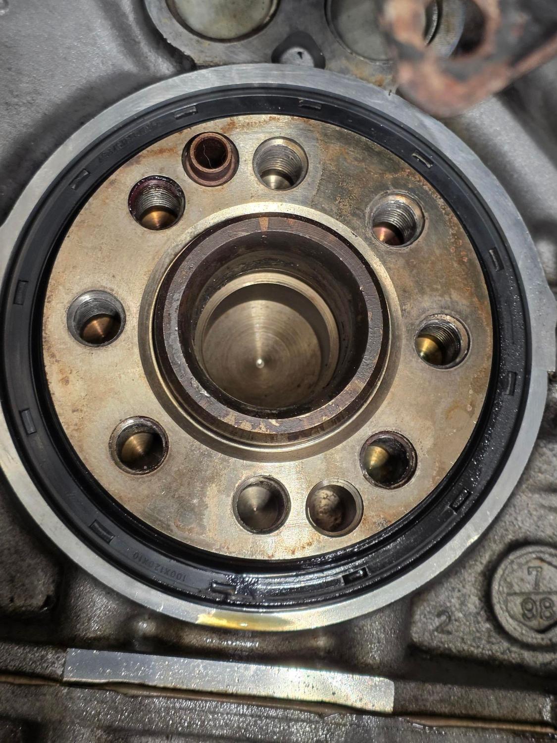

The last time I was in there (4th time) the seal was installed flush. It looked like it failed at the 5'oclock position. It was the only place it looked like it was weeping from. i will try to post pics soon.

Weeping between crank and seal or block and seal ? Some have a coat of sealer when fitted.

Old Mar 28, 2026 | 02:48 AM

Is the shaft where the seal bears onto it in perfect condition, i.e. no grooves or marking?
Does the seal come with a plastic insertion tool? If there is no tool and the shaft is in perfect condition, do you think that the lip might be being damaged when you slide it over the shaft? If so, you can use clingfilm or similar, which is removed after installation, on the shaft to ensure that the seal is not damaged.

Looks like some sort of damage at the 5 o clok point . You would usually have a large diameter tube ( or socket) to push it in square . Unfortunatly for you its a lathe job to make up a good tool
