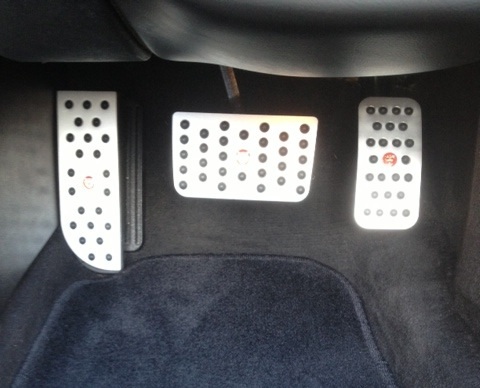

Ok. I'm sooooooo sick of this issue!! I've cleaned all the sensors, checked the module, and low and behold that darn warning started up again.
BUT! This time I may have a culprit. It had stopped for a long time and I thought it was finally settled. It usually only came on when I put it in reverse and even then one once in a while. But about three weeks ago it started coming on about every other time I started car!
I started to pay attention to what I did as I got in the car and noticed that if I so much as tapped the brake pedal, the abs/trac light would come on when I started the car and stay on until I let it set a couple hours after driving. So it tested my theory and sure enough, if I have my foot on the brake or even accidentally tap it while getting in, the warning always comes on. But never does if I can avoid it before starting. Once started, no problems.
Now I'm hoping someone will confirm that it's probably something in the brake pedal switch, an easy fix. Although not a cheap part!
Here's why I think it happened. I ordered the aluminum pedals from Mina Gallery, which I highly recommend!! They are really awesome!! But during installing, I didn't realize that, having to put a great deal of pressure on the pedal to drill through, I may do damage to the switch. I mean its HARD steel!!! And I bought new bits. Hindsight, I'd have used a block of wood behind. I may have to email Chris and suggest he add that to the instructions, not that I'd read them anyway!! Lol
