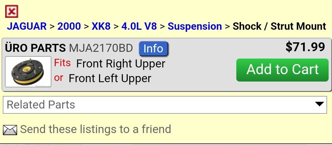

I have not used these myself, but have used several other üro parts without issue.

If URO is the way you are going, let me help with that price.
https://www.oreillyauto.com/detail/c...ount+URO&pos=3
Have them in hand and ask what someone will put these on for.?
Save the old mounts and send them to me at my expense of course.

Wayne, that's interesting. My Welsh mounts are failing, but I don't want to tie up my lift. So I could buy the mounts from O'Reilly, send my Welsh mounts to you for rebuild, which I have been planning on doing, and when the URO's fail ask for a refund. Of course, I'm still stuck with the pain of replacing the mounts an extra time, but working on my cars keeps me active. Sounds like a plan.

RJ, I have a member in CA buying the URO mounts and sending them to me for rebuild, throwing the new guts away, as he doesn't want to have the down time either.
He will send me whatever he is taking off also, so I might get ahead and save all this extra expense.
Be glad to help on a fast turnaround, if that would help, you are close and Priority Mail is $17.10.
