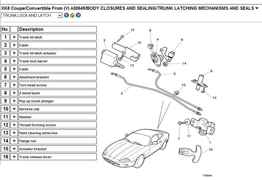

A light rear impact could have affected the luggage compartment latch sending a false 'open' warning:
There's also two vulnerable modules at the rear of the vehicle:
Item 4 (Anti-Theft alarm and double locking module) and item 5 (Parking Aid module).
Following the accident, a loose connection or physical damage to the latch sensor or the anti-theft alarm module are possible causes of false and random alarms.

+1 to Graham's idea.
Worth checking the battery connections at the same time - if they've been shaken loose that can trigger an alarm when the car's locked.
