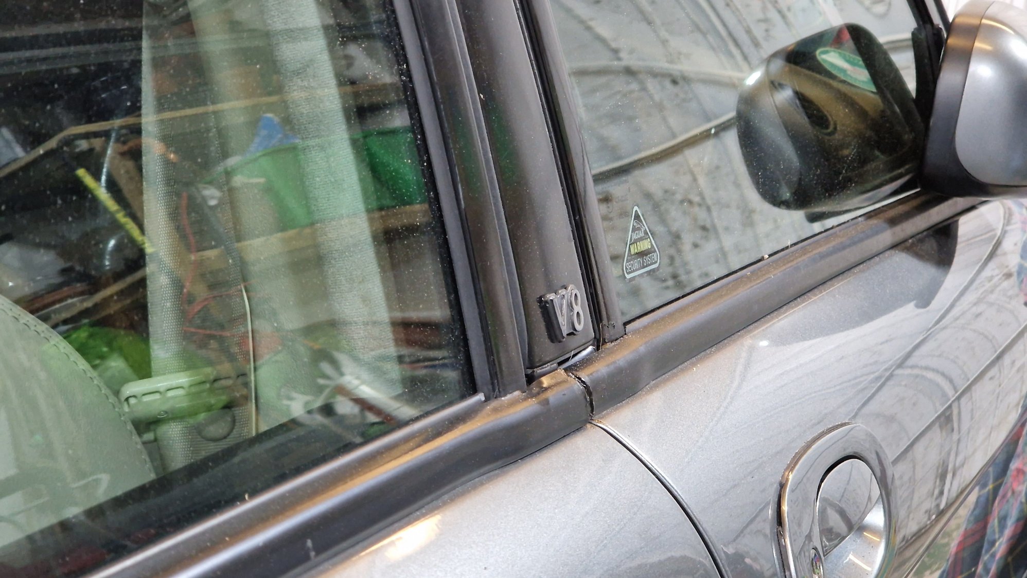

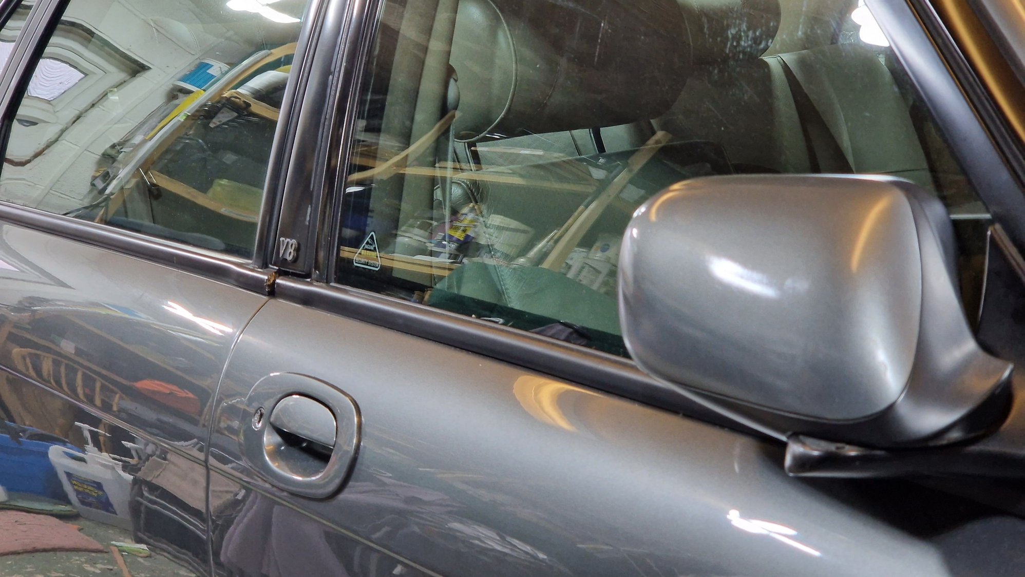

Default Corsa trims fitted to 90s Jags
Here's the Corsa items on my XJ8
Not quite a perfect fit yet, but with a bit of skill and more attention to detail, I reckon it's a fair solution.
And here, for comparison, is a spare, unmodified Corsa waist seal above the original items on my XK8. I've got to say, I did get some funny looks walking around the car park at Sainsbury's measuring window seals on various 3dr superminis!

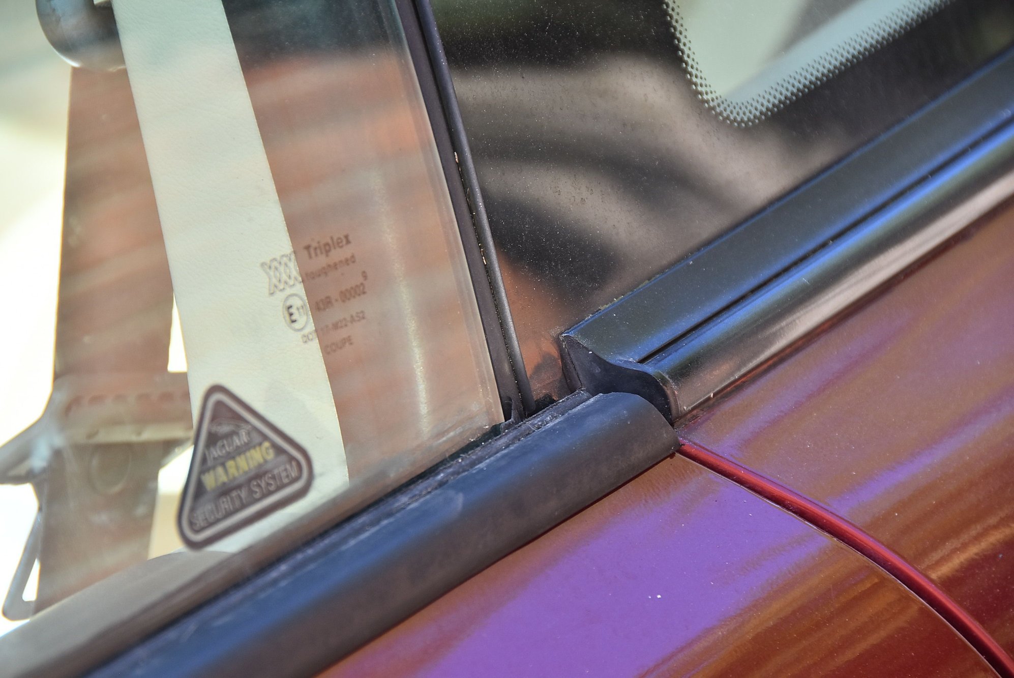

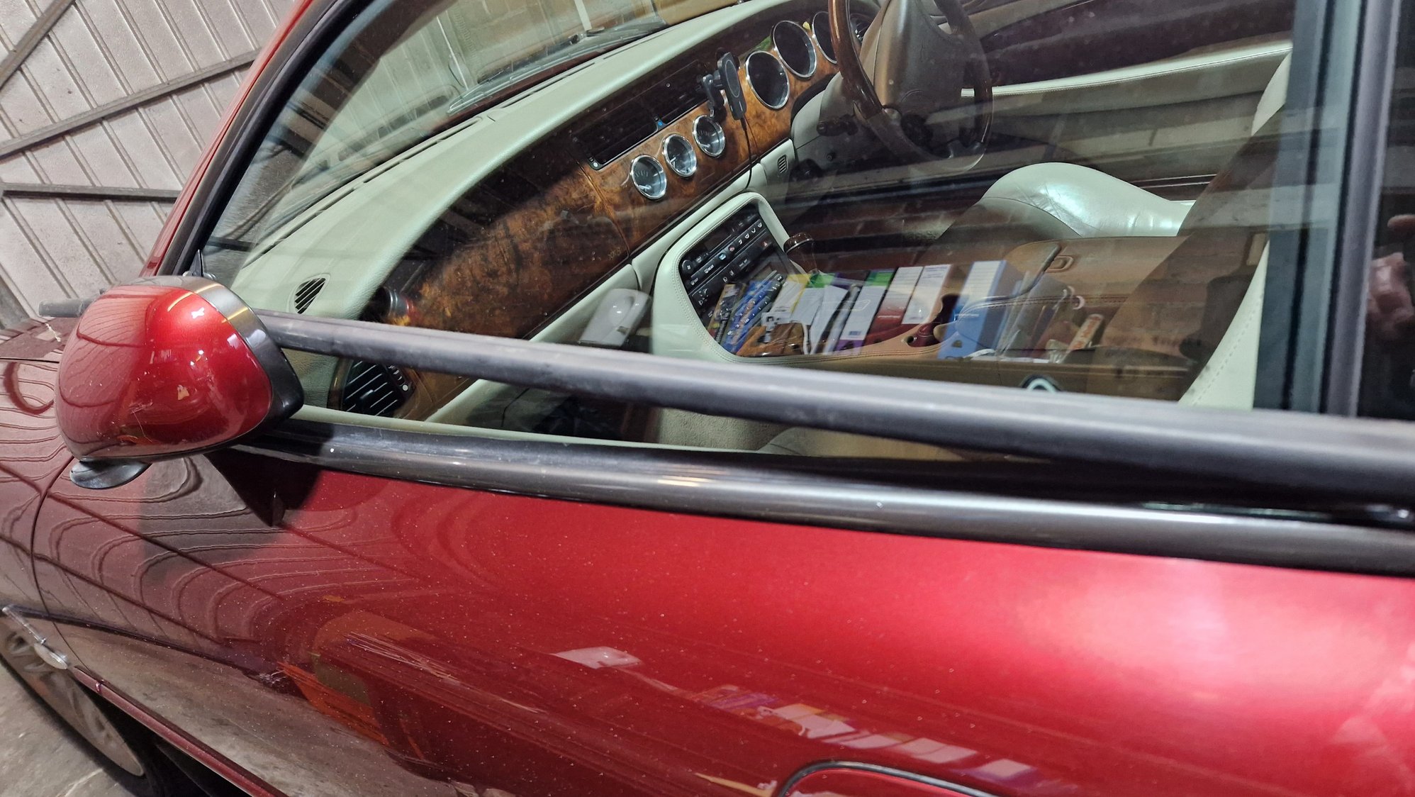

Well they came ..cleaned them up ..cut to length ..clicked into place nice and solid
BUT...the originals have a wiper that goes up the window ,these do not so while it looks fine and does a good job at "wiping" it dont look a match at the rear of the door ..( coupe) think it would be OK for a convertable.
Think I will sand and fill and re paint the originals and keep them for shows or resale
window frame matches the wiper on a coupe...
