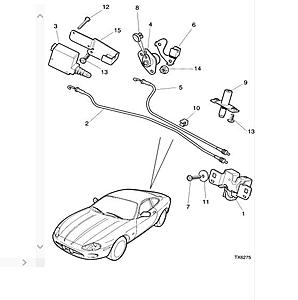

I hope it is only a sticking Valet Switch because this is what you're up against:
ANOTHER "I can't open my trunk" post...stuck in valet mode.-locking-mechanism.jpg
The latch is normally tripped electrically by the Actuator (item 3) on the left of the diagram pulling on the bowden cable (item 2) which you can see is clipped to the inside of the luggage compartment.
A second cable (item 5) goes to the lock barrel (item 4) between the X and K on the lid for opening with the black headed key:
