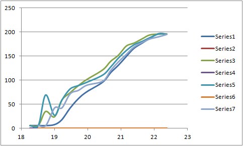

Doing WOT runs in the XK is tricky to get a clean run, as you cant hold it in any gear except 1st and in 1st you will spin the wheels.
1st is not ideal either as you will get a limited number of data points for a nice graph but you have no choice really.
Put it into sport mode so it will start in 1st then ease it into WOT over half a second to avoid wheel spin. If you record the data you will get something like this (these ones are plotted against time rather then RPM as you get twice the data points).
You can see 4 attempts here, 3 with wheel spin and one where I eased it in. My peak is about 195 but so far no one else has posted up any other 4.2 NA results so I also have no clue if mine is faulty or not.

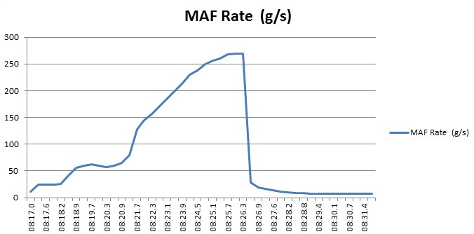

Thankyou all for the tips. Here's my run in 2nd up to the limiter - my peak is 269. This seems a little low from some of the posts above. I have previously tried cleaning it with electrical contact cleaner; is MAF cleaner much different? Would you replace with these values?
Attached Thumbnails Anyone have MAF readings for 4.0L XKR-13284396715_efc406fd2b_b.jpg

For the time being you need to put to one side the "what it should be" comments until there is some more evidence.
In a previous post ccfulton said that he had measured the MAF on a bench to calibrate it and found that the ecu was reporting values less that the calibrated air flow. The ecu reads a voltage from the MAF and acts on that value, then probably calculates a g/s value to feed out of the OBD2 port.
My car peaks at 195g/s which also seems low, so ccfulton's suggestion seems to fit my car too.
Thus what is needed is a real comparison to other real cars.
However, last night I cleaned my MAF (with break cleaner) and the peak value dropped by 5g/s, yes I know I should have used MAF cleaner so don't give me a hard time.
As a result I bought a new one from ebay last night as they are fairly cheap, I will get it in another couple of days and will let you know if it also reads 195g/s
Air Flow Mass Meter Sensor for SUBARU MAZDA JAGUAR XK XJ MAF 22680-AA310 | eBay
Here is some flawed thinking that others can comment on;
if we say that my 195g/s ---> 290bhp (was 300 when new so lets say I've lost 10)
your 260g/s ----> 260/195*300 = 386bhp, looks like you have gained some, must be the car wax you use or you lose some hp to drive the supercharger.

Forget the true airflow, the gr/sec is just a calculation from the voltage, and you can only compare this with similar cars, so AJ27 SC engines (not AJ26 like I guess XJR-99 is showing?).
I do think 269 is on the low side, about 300 would still be ok, but it's way to long for me to remember all the details of my measurements although I am relatively sure it was a stock setup for the 320.
PS Personally I don't like the cleaning part, and it would not surprise me that it affects the MAF sensors sensitivity, so would limit cleaning actions only if there is really an issue/heavy dirt.
