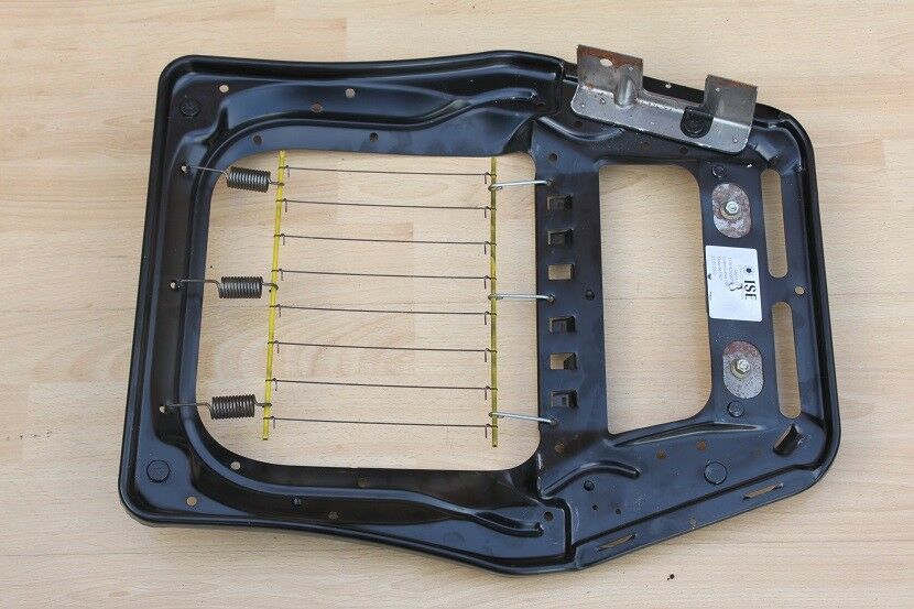

Anyone know where to find the Wire Basket replacement for the seat..? I've exhausted the inter-web looking for it...?????
I just reupholstered the drivers seat and the same issue with mine...rubber diaphragm was split and torn...can't repair it as is. I would prefer the newer wire baskets. Passenger side is good and I could swap...but...rather just replace both and not have to think about it later.
Thanks

I looked at Rothwell’s wire basket but trying to replace rubber diaphragm with the new springs is way too difficult. Different orientation. Easier to just get a complete new seat. But these are NLA, so you have to go to scrap yard, and that is always a lottery.

I found one in the UK. Not cheap though.
At least you can see what it looks like. Good chance it is a common Ford part since the rack is Ford. Perhaps you can find a match.
https://www.ebay.com/itm/SEAT-CUSHIO...cAAOSwhY9cSvwM

I think it may be cheaper to just find an upholstery shop and/or try to find a wire basket from another seat and modify it..??? I'll keep looking....

I agree that it may be best to talk with a well-respected, long-time-in-business upholstery shop and see what they suggest. If they come up empty, I would then find a well-respected local metal shop and see what they could fabricate for you. This would be relatively easy for an experienced metal shop to create. You just need to find one willing to help you for a reasonable price....
