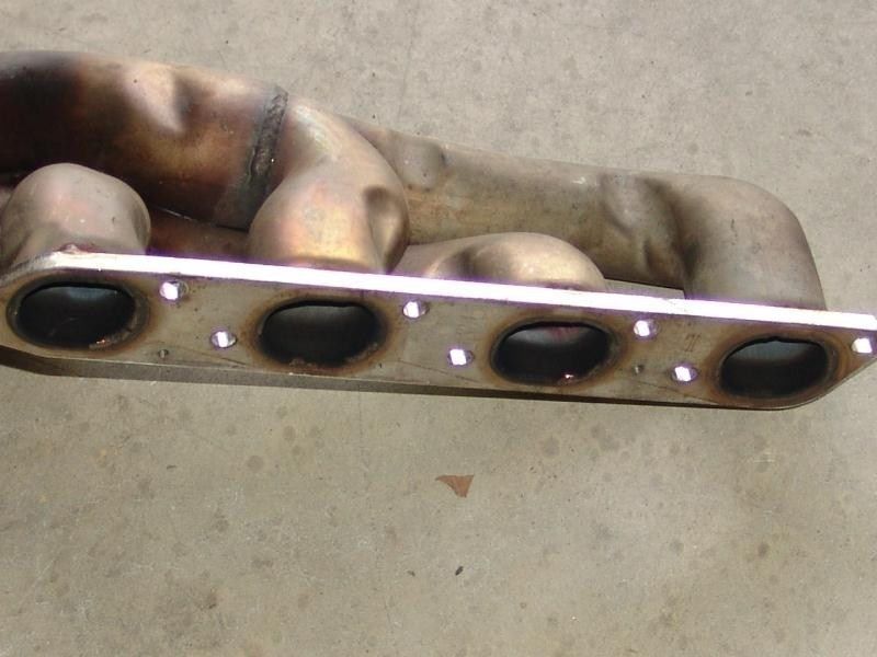

There is a pair of V8 Vantage exhaust manifolds for sale in the UK at the moment
ASTON MARTIN V8 VANTAGE LH EXHAUST MANIFOLD | eBay
ASTON MARTIN V8 VANTAGE RH EXHAUST MANIFOLD | eBay
No idea if they fit.
Old Jan 6, 2013 | 09:52 AM
XKRacer's Avatar
Joined: Oct 2010
Posts: 2,255
Likes: 585
From: UK
They don't unfortunately.... The steering column is in he way
Old Jan 6, 2013 | 11:13 AM
bfsgross's Avatar
Joined: Nov 2009
Posts: 5,084
Likes: 432
From: NY
Bet a skilled exhaust modifier can mock up a pair of shorty headers using the stock manifolds to fabricate the flange then bend tubes from there.
Old Jan 6, 2013 | 11:38 AM
XKRacer's Avatar
Joined: Oct 2010
Posts: 2,255
Likes: 585
From: UK
Yes of course and it has been done...... They are not cheap....

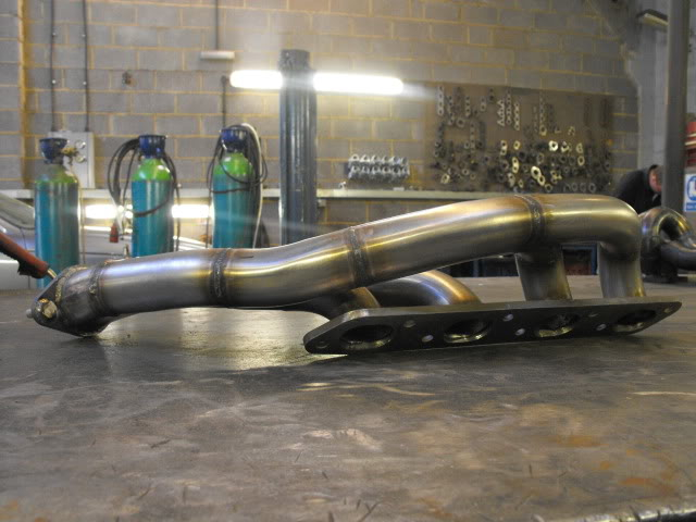

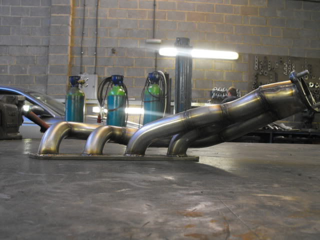

Attached Thumbnails Aston Martin V8 Vantage exhaust on a 2005 Jaguar XKR?-05b183b29055659adbc62c5a3447111d.jpg   Aston Martin V8 Vantage exhaust on a 2005 Jaguar XKR?-6d039b0fe5cadf882d7c7ed62afa3be3.jpg
Old Jan 6, 2013 | 12:35 PM
bfsgross's Avatar
Joined: Nov 2009
Posts: 5,084
Likes: 432
From: NY
Thanks XKRacer. Post header install: Was there a difference in performance and noise?

Those headers are a work of art.
Old Feb 12, 2014 | 07:14 AM
User 070620's Avatar
Posts: 1,462
Likes: 304
are certainly interesting. As you can see the configuration is 4 into 2 into 1.
If I remember correctly, however, the intersections had to be between cylinders 1 and 3 then 2 and 4.
As you can see from the collectors of the Aston Martin V8.
In this case instead intersect the cylinders 1 and 2 and then 3 and 4.
but it is certainly better than those horrid original cast iron manifolds!
Attached Thumbnails Aston Martin V8 Vantage exhaust on a 2005 Jaguar XKR?-sx_6g33-5g232-bb.jpg   Aston Martin V8 Vantage exhaust on a 2005 Jaguar XKR?-%24t2ec16n-zce9s4g091nbrptceu-vq%7E%7E60_3.jpg
Old Feb 12, 2014 | 11:03 AM
XKRacer's Avatar
Joined: Oct 2010
Posts: 2,255
Likes: 585
From: UK
I don't make the headers personally but I can get them.... £2000 a set!
Old Feb 12, 2014 | 12:20 PM
avos's Avatar
Joined: Apr 2008
Posts: 3,616
Likes: 1,070
From: Europe
The left hand side doesn't look to good imho as no 7 an 8 fire one after another, so for better performance that should have been separated as a true 4 2 1 system.
Any HP figures of what can be gained for that amount?
Old Feb 12, 2014 | 01:02 PM
XKRacer's Avatar
Joined: Oct 2010
Posts: 2,255
Likes: 585
From: UK
I don't have any BHP figures to show at the moment and to be fair true performance headers are equal length and the problem with the XK is space, I do believe these headers also require bespoke made cats which cost another £1000, it is a lot for the gain that may be acquired
Old Feb 13, 2014 | 12:07 AM
avos's Avatar
Joined: Apr 2008
Posts: 3,616
Likes: 1,070
From: Europe
The last dynos I saw from huge equal length headers of a 4.0 XJR (probably indeed not possible on a XKR), only showed a gain of about 15 rwhp to my surprise, so I have no hopes on the headers you have shown. Are you going to do some dynos with these ?
