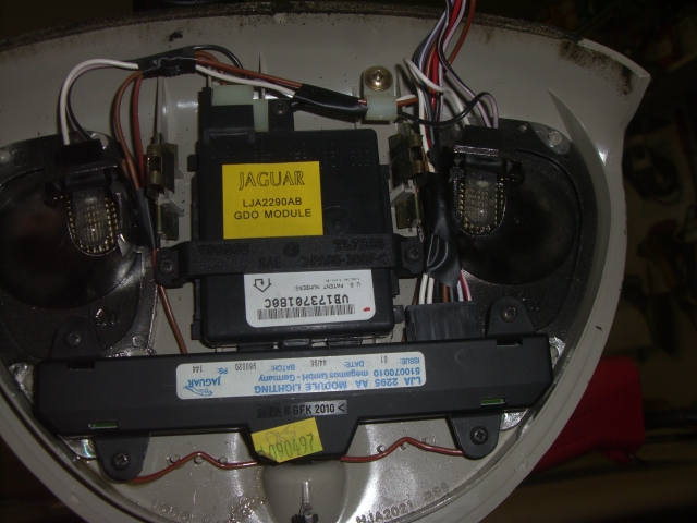

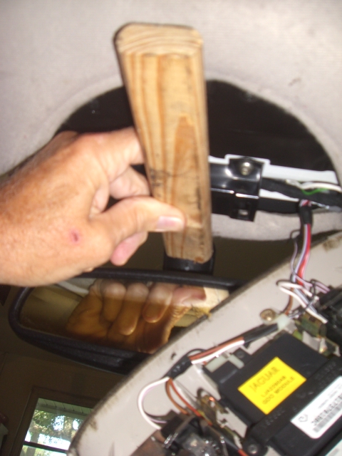

Default Pictures from the First Post... could not edit and insert.
Here are the pics for the original post. The post is so old, the edit function is unavailable, e.g., no edit button. Maybe someone with access to forum programming could insert them into original post. It would certainly help someone viewing this thread for the first time. gordocatcar
Attached Thumbnails Auto Dimming Rearview Mirror Replacement-mirror.1.jpg   Auto Dimming Rearview Mirror Replacement-mirror.2.jpg   Auto Dimming Rearview Mirror Replacement-mirror.3.jpg   Auto Dimming Rearview Mirror Replacement-mirror.4.jpg   Auto Dimming Rearview Mirror Replacement-mirror.5.jpg
Auto Dimming Rearview Mirror Replacement-mirror.6.jpg   Auto Dimming Rearview Mirror Replacement-mirror.7.jpg   Auto Dimming Rearview Mirror Replacement-mirror.8.jpg

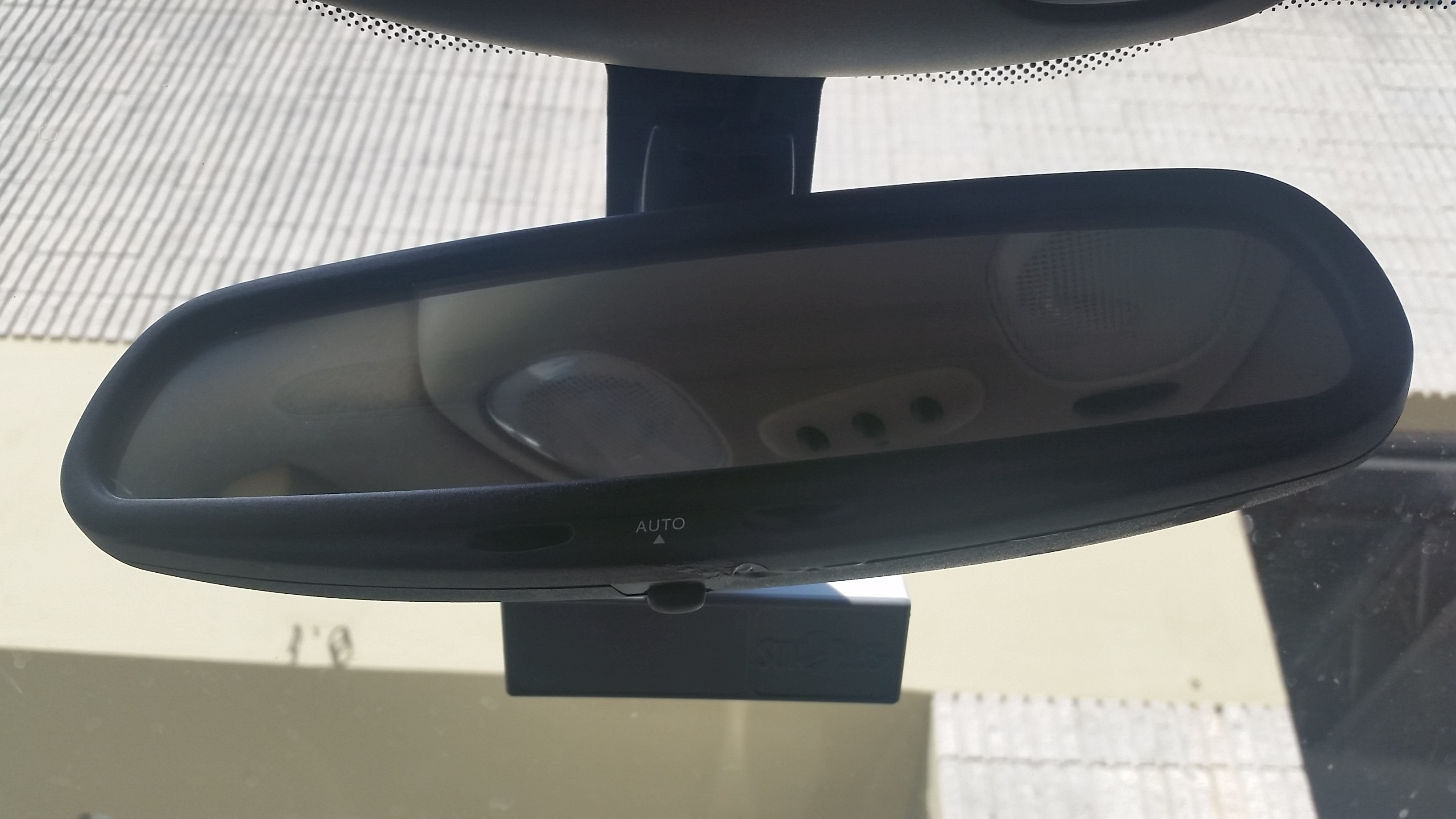

Thanks to all the posters and their contribution to us backyard mechanics, this thread on mirror replacement has been great to read. Now, enough of the reading for me and onto the doing, I will be having a go at removing the mirror tomorrow. I will let you know how it goes and contribute my two cents.
Thanks again.
Old Mar 22, 2016 | 09:25 PM
  #258
Jandreu's Avatar
Posts: 2,173
Likes: 605
From: Goldsboro, NC
Default details for a MY 03 mirror
Just thought I'd add photo's for an 03 car mirror mount as it is different than the earlier ones, however the same instructions still apply!
A little lube and downward push with a slight wiggle and it came off.
Old Mar 28, 2016 | 06:19 PM
  #259
tlynch's Avatar
Joined: May 2015
Posts: 130
Likes: 11
From: Central Texas
Default What a difference!

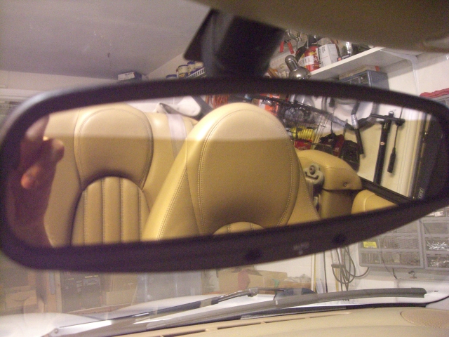

I finally yanked my mirror and sent it off to be refurbished. It made a huge difference. The auto dim works well, and fairly quickly.
Before
After
Random notes:
  • The whole job went pretty smoothly, and none of the windshield nightmares occurred. This thread and accumulated forum experience definitely helped my comfort level.
  • You have to pull the overhead console pretty firmly to get it down. I'm not going to lie: I was nervous since I have broken plastic mounting points on other cars before.
  • When re-installing, you may want to go ahead and tighten the screw on the clip. My mirror had a jiggle because it was loose, so I had to pull it off again.
  • Sybesma prices went up since August, 2015. I opted for 2nd day delivery and paid $125.
  • They received the mirror on a Monday, shipped it out on Wednesday and I got it back on Friday. You can trade more money for more speed going and coming.
  • I got used to driving with no rear view mirror more easily than I expected. Having the top down is a big help.
  • Other people who drive your car may freak out when they realize there is no rear view mirror.
  • Apparently I was used to the "New Mexico landscape" look before the repair. I'm still a little startled when I look at the rear view mirror and I can see a clear reflection.

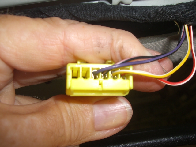

My mirror went out as well. I purchased a used one on Ebay for $55 that came out of a 2007 Acura TL. It has the same item # 11530 as mine does.
Only issue is that the yellow connector from the old mirror has 6 wires, Brown,Green,Yellow,Black,Gray, White and the Acura mirror only has 3, black, white and gray. Does anyone know if I just go black to black, white to white and gray to gray?
