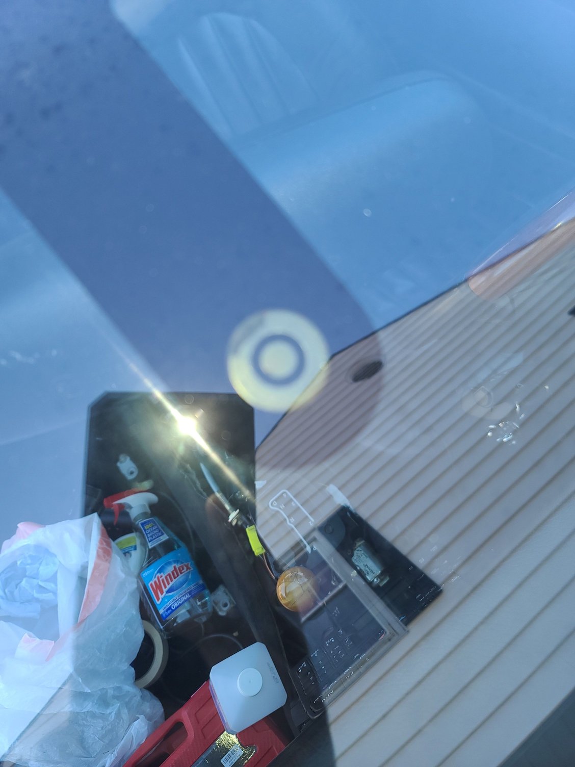

Currently working on tint removal in the rear so I was able to snap a picture. Do you know what it should look like? I'm guessing I should remove it and clean off the adhesive and do a light test as well correct?
that last picture looks strange. is there something between the sensor and the camera???
its not the black glue i thought, but looks like paper?
twist the sensor off and look pls

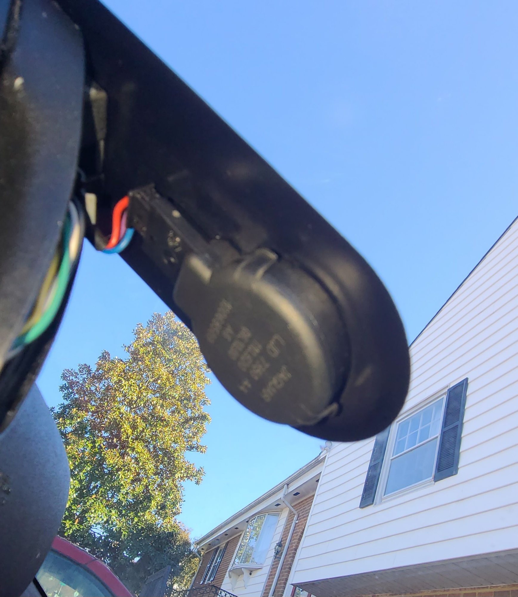

Just did about 20 mins ago, I cleaned the adhesive off and it had no effect on the auto on and off function for the headlights.
I believe that's actually for the rain sensor.

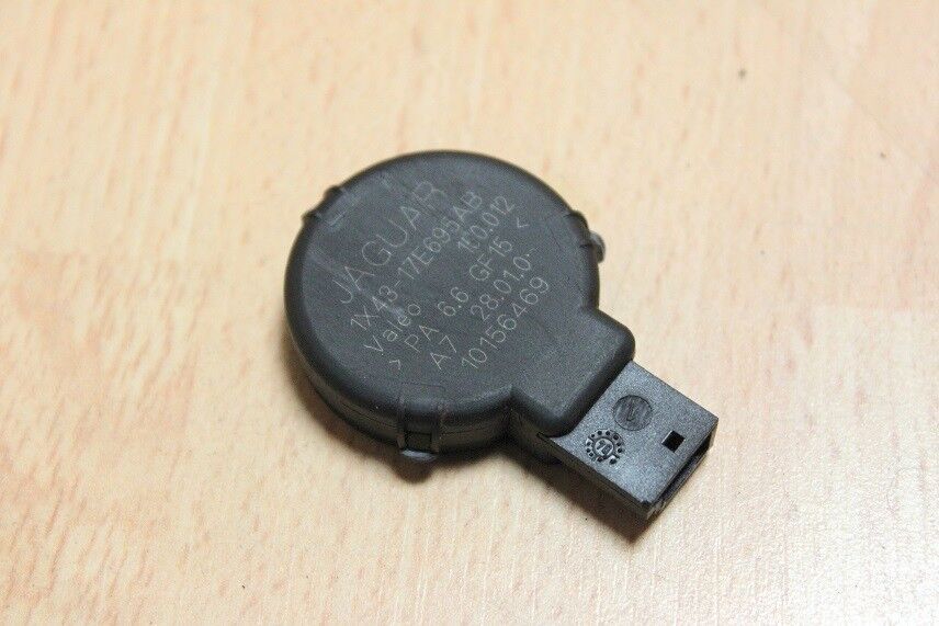

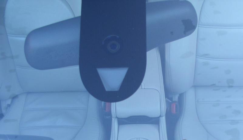

that looks different on my xk8.
i found some pics how it looks at mine for example. the round one is the rain sensor. the other one is the light sensor
rain sensor
light and rain sensor
edit: https://www.jaguarforums.com/forum/xk8-xkr-x100-17/auto-headlight-sensor-where-59815/
here it states the light sensor in the mirror. strange
edit: https://www.jaguarforums.com/forum/x...r-where-59815/
The light sensor is in the mirror (facing forwards). The sensor pictured is the rain sensor for the auto wipers.
