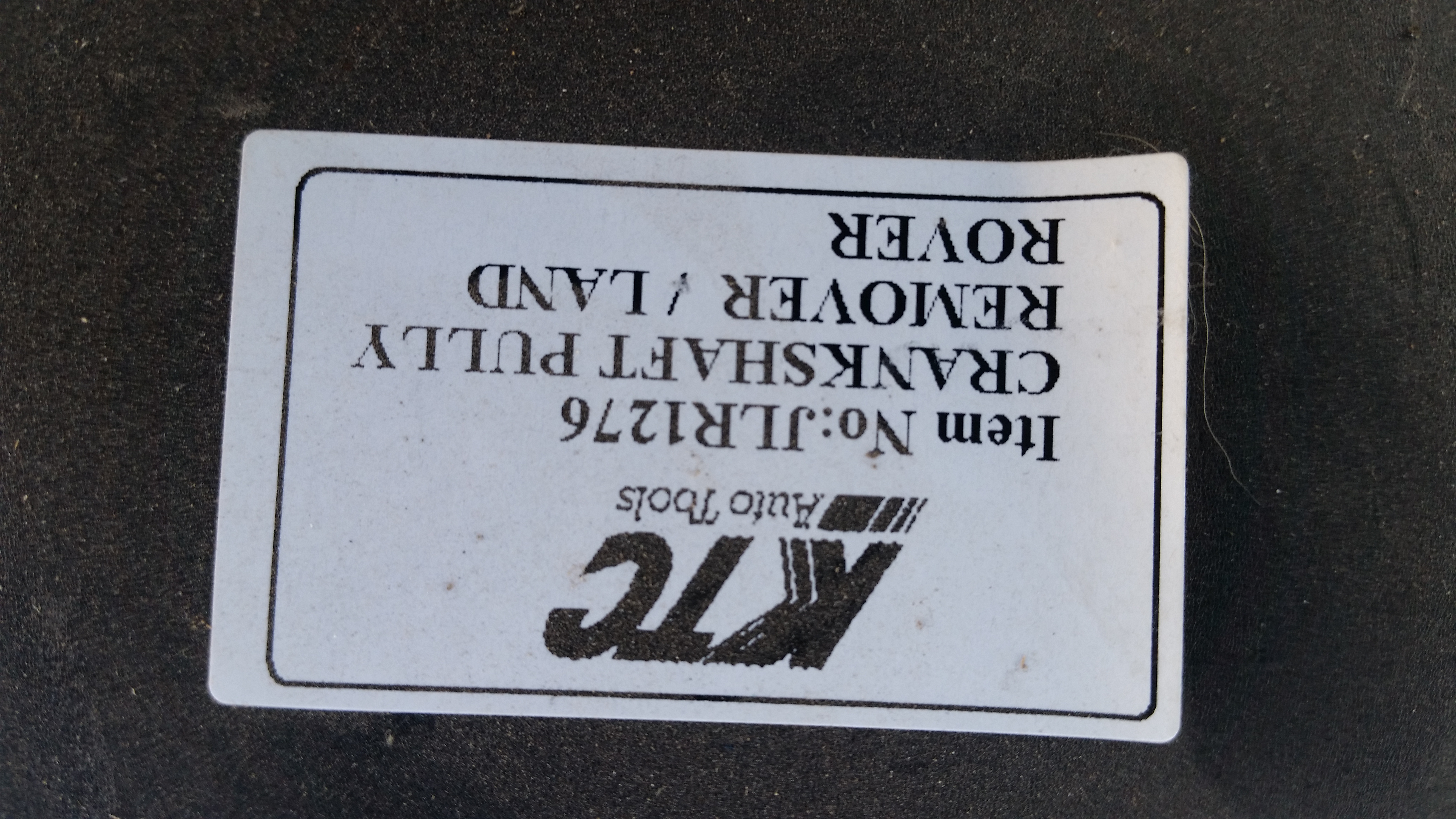

Hi BobRoy,
Can you post pictures of the balancer removal kit or an eBay link for the kit? Was it more difficult to undo the balancer bolt than to pull the balancer out?
My indy mechanic used the starter motor trick and no heat to avoid damage to the rubber; apparently pulling the balancer off was not a big deal as compared to the nut removal, perhaps due to the Loctite that was applied to the bolt threads.
TIA
Originally Posted by BobRoy
I have removed 2 different balancers off in the last couple of weeks. I have a balancer removal kit that makes it a piece of cake. It has a lock tool so you can remove the balancer bolt wit h out the motor turning. After you get the bolt off you put a plug that comes with the kit in the hole that the bolt came out of. Then attach the puller and the balancer comes off slowly with no problems.
The first one I took off was on a 01xjr. I bent 2 pullers and still could not get It off. I found this puller kit on ebay and along with a timing tensioner installation kit. These tools have been extremely convenient.
Old Jul 6, 2016 | 08:53 AM
BobRoy's Avatar
Joined: Jul 2015
Posts: 1,536
Likes: 790
From: Sacramento, CA
Neither the bolt or the balancer were that difficult to remove with the kit shown below. I did use a 4' pipe over my breaker bar to remove the bolt. I purchased the kits about a year or so ago. I don't remember the vendor or how much I paid for them. You can Google to see if anyone is selling them and for the best price. Sorry for the image being upside-down I'm not a photographer.
Attached Thumbnails Balancer/pulley removal Help needed!-20160706_063748.jpg   Balancer/pulley removal Help needed!-20160706_063708.jpg
