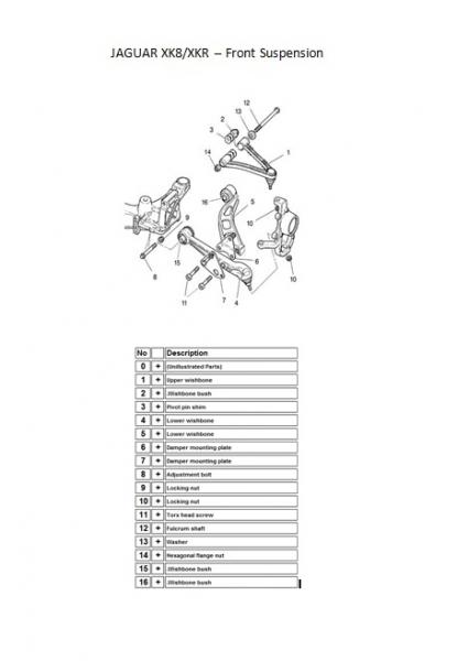

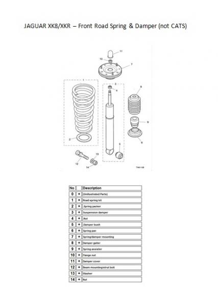

The car has to undergo a yearly roadsafety inspection; 2 years ago had to replace both of the rear shocks, not that it was failing but the damping difference between left and right was to big.
So I recon the dampers are ok, but any bushes in perticular that I should have a closer look at?
To Nori: I always lock the car, was even thinking to leave the car unlocked to avoid the usage of the alarm.
Regards,
Luc
Old Sep 6, 2012 | 07:34 AM
Originally Posted by Bleujag
To: GGG
So I recon the dampers are ok, but any bushes in perticular that I should have a closer look at? .................
Luc,
If only the rear shocks were replaced, it's time to check the fronts. The shocks themselves may be OK but the top mounts (item 7) and bottom bushes (item 5) do wear:
With the wishbones, it's the upper bushes (item 2) that wear the fastest:
The options here are stick with Jaguar OE or go aftermarket Polybush.
