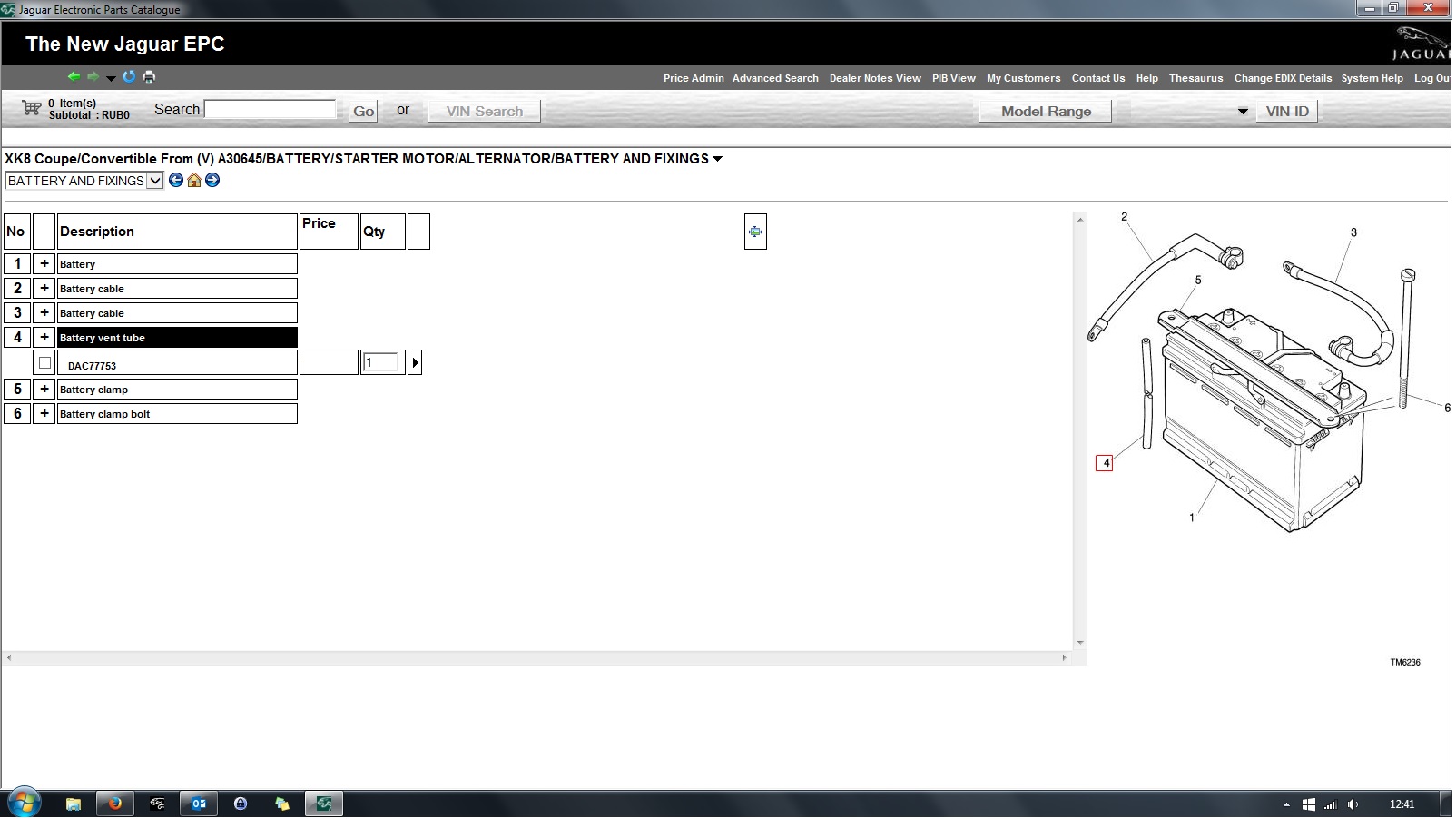

Although the battery has plugged vents at either side, you should only remove the LH one and fit a single elbow.
The vent tube (item 4) is acid resistant:
Jaguar P/N is DAC77753 but a similar grade has to be readily available from other sources. Washer tube is not a suitable substitute.
