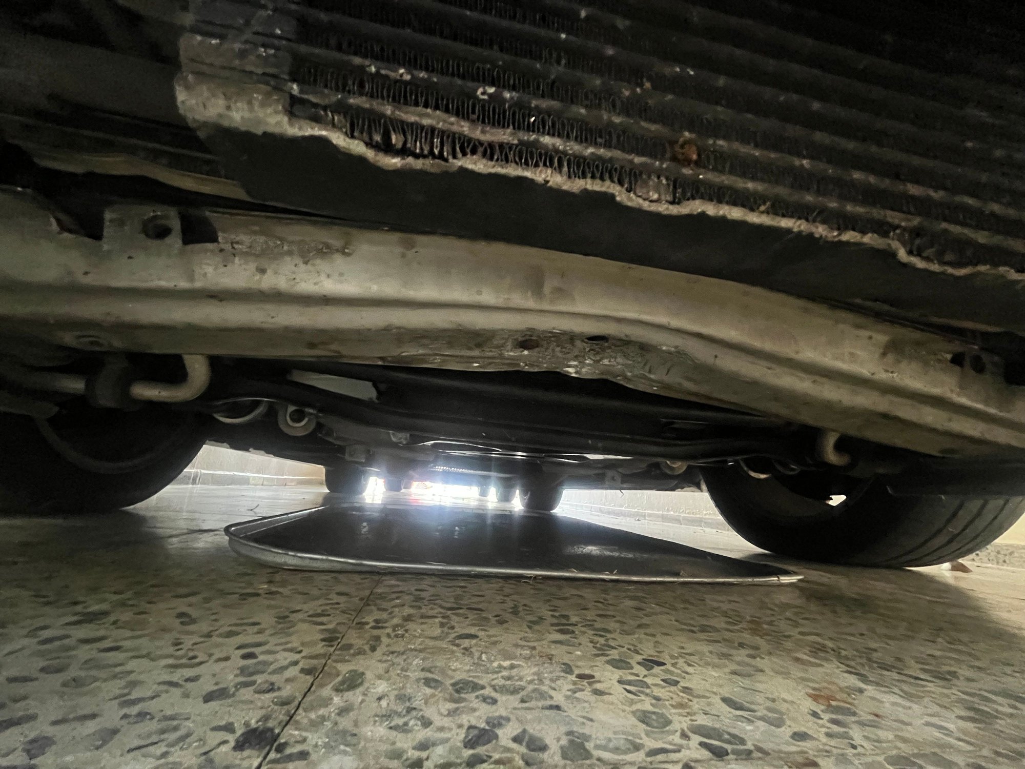

Here's one that I have no idea if I can fix without taking it to a body shop, or if it means my car is ruined now.
I got a nail on one of my tires yesterday. I drove on my spare for a bit (donut spare) until I could pull in to the nearest mom-&-pop's tire shop. I paid for a tire patch and was ready to just have them work their magic. The technician, a young lad about 18 proceeded to jack up the car from the front subframe piece (the under directly beneath the radiator). He didn't put a wheel chuck on the rear while in a small gradient (less than 15º). Then I watched in horror as the car rolled forwards as his jack tilted sideways. I heard a loud clunk. The jack somehow caught on an imperfection in the ground and was tilted sideways, which prevented the car from slamming onto the ground. No one got hurt but...
My lower radiator support is now quite bent, and the plastic cover was sheared off. Miraculously my radiator is intact but, it is now unstable in its possible. The shop owner gave the kid a proper scolding and then sent over a more experienced employee to finish the job. Got the patch done, and drove the car. It drives well. Just like before the damage. No alignment issues, no noises. Everything seems fine. The radiator didn't lose a drop of coolant either and there were no differences according to the RealGauge.
Can this damage be fixed? And if so, how? Would insurance total the car over this? I think I would like to get it fixed without involving insurance for fear of them totaling the car. In fact, I would like to learn how to fix it myself if possible without a chassis straightener.

Last time I got my tyres done I told them exactly where to jack the car up, I used the side jack points only because the one you used never seemed all that strong to me. I guess thos proved my point. I would say this could be bent back but it will probably be weaker.

I would expect that will straighten out relatively easily with a bit of ingenuity.
For what it's worth, that is the designated lift point at front and l have used it many times without issue, but usually use a timber spreader between the crossmember and jack.

That is 100% the responsibility of the tyre place to fix.

As others have said, that is an official jacking point which I have used many times and, just because the car has rolled forwards, I'm amazed that that alone has caused so much damage.
I'm sure that it can be straightened but will presumably need the engine to be removed. I'm sure that an insurance company will write it off as structural damage so I would get some quotes without involving them.

A body shop will be able to fix that easily.

while they are at it , have them do a bit of reinforcement. Once it’s been bent, it will bend easier the next time around.

I was able to speak to the shop owner. He informed me that the incident report we had made had already been sent to their liability insurance company and they will be contacting me shortly to send an insurance adjuster to assess the extent of the damage. I then have to go to a body shop to get an estimate. After that process is taken care of, the insurance company will verify the estimate and approve the fix then make a check to me or the body shop. Apparently, because of corporate bureaucracy, the process may take a few months. Go figure.

One other thing to check on is for any damage to the AC condenser.
