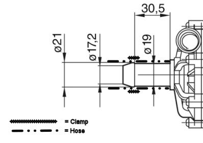

I have recently fitted a Bosch intercooler pump. All working fine but I have some concerns.
When attaching the hoses I found that the spring hose clips did not give a tight fit to the smooth section of the pump outlets (original pump had 20.2mm corrugations and 21mm flange. See this thread post #4 for pump pictures https://www.jaguarforums.com/forum/x...eat-fix-75561/).
So I repositioned the clips to clamp over the wider flange part of the outlets. See drawing
My concerns are:
Is this connection going to be secure or could the pipe slip/pop off under coolant pressure?
Also with the clamp in this position, although the clamp pressure does not seem too excessive, is it possible the flange could eventually cut through the rubber at this point?
Would I be safest to fit a Jubille clip? Or is all going to be OK?
How did other people that have fitted this pump proceed?

Jubilee clip. You need to get the clamp onto the narrow part of the neck.
The type made for fuel hose or the wire type clamps are better because they apply clamping pressure 360 degrees.
Umm... did you move the pipe assembly from the old pump to the new pump? That way you get to keep the connections as they were.
Yes, I thought when I asked the question that the best way would be to fit a new clip.
As I changed makes from the oem Hella to Bosch I thought it best to use all the new parts.

When I replaced the original Hella with the Bosch I used new stainless steel "worm gear" or as you chaps say "Jubilee Clip" clamps with no problems. Ok now I've got to go and "Hoover" the carpets. I mean vacuum!
