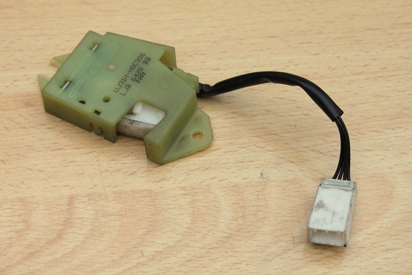

You can double check the trigger part of the switch (the white plastic part). It is actually adjustable. There are 2 separate plastic parts pressed together and joined by small plastic teeth, which allows these parts to be forcibly moved in relation to one another and remain in place after adjustment. IOW, the trigger can be collapsed or expanded to fit the peg on the pedal and properly activate the underlying switch.
The "dirty" part and the whiter part in the image below can slide in relation to each other.

The two separate parts are a 'ratchet-style' assy that is designed to set at the correct position when the brake pedal is released to the top of the travel. (at rest)
You will hear a clicking while the parts ratchet into position and then leave it alone. Do NOT PULL the brake pedal UP, just let it return naturally.
Pulling up will over extend the travel and the brake lights will STAY ON.
I replaced many brake light switches in the X100 and X308 cars and did PULL UP once. I had to pry the two parts apart and let the pedal set itself while 'stuffed' under the dash to gain access.(it can be done with a small 'hook-tool' while in-situ)
