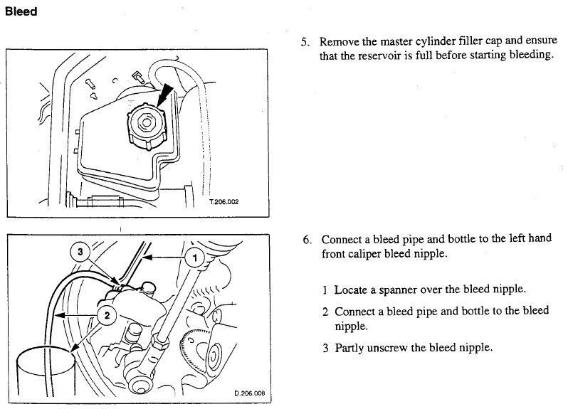

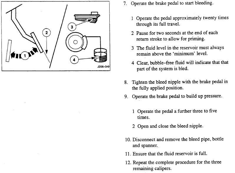

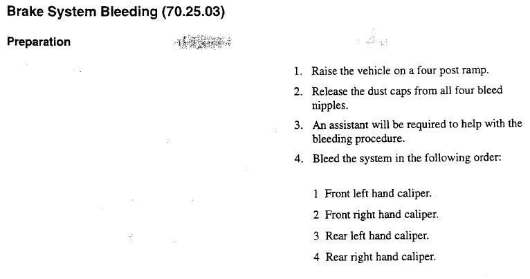

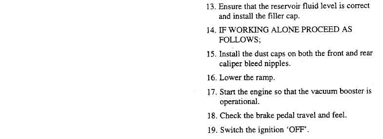

The X100 is supposed to be bled in a different order than the traditional one (caliper farthest from master cylinder then working to the one closest). Instead, the X100 order is front left, front right, rear left, rear right. The procedure for pumping the pedal is also different. Here are the instructions from the 1998 Workshop Manual:
It's unfortunate that you can't get the ABS module to kick in, because sometimes that can help if air is trapped in the module. I can't remember if IDS/SDD has a routine for running the pump during brake bleeding to pump air through the modulator so it can then be bled from the caliper nipples, but you might research that possibility. If your brakes are working well enough to engage ABS, you might try doing so repeatedly, then bleeding all for corners again in the above order. Sometimes that will do the trick.
