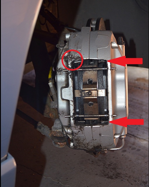

Is that the steel plates top and bottom (arrowed in red) that the pad backing plate slides on?
As you can see from the photo, the top left of this caliper is showing corrosion but there's no distortion of the steel plate. Just how bad are yours?

Hi,
Yes, there are 2 steel plates above and below the pad. The corrosion under the plates is lifting the plate and causing the pad to stick, resulting in a loud noise on braking
