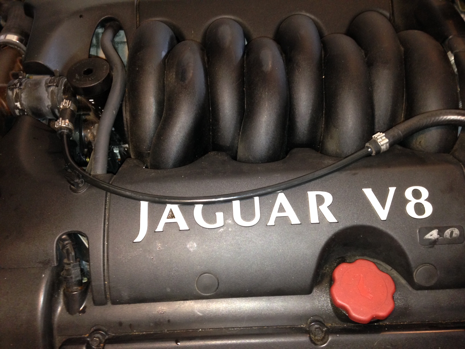

The plastic line running from the expansion tank to the thermostat tower has broken off on one end just enough it cannot be secured properly.
It runs in between two small rubber hoses that connect it to the tank and tower. (see picture)
Is there any reason I can't just eliminate it and replace the entire 3-piece line with a single rubber hose? (other than it will no longer fit in the holding piece on the cam cover)

Default Resolved
Purists, concours judges and general OCD types better not go any further.
Here's my temporary fix in place. Got engine up to near operating temp and it seems to be just fine. Even managed to spill a little coolant while swapping hoses so I have that sweet smell I have been missing for many months.
May try to get the OEM part when I order my shock mounts and springs (next real project)... if it's not too much $$. Just to clean up the look.
Be doing some errands later today, so we will see, but I suspect this is resolved.
