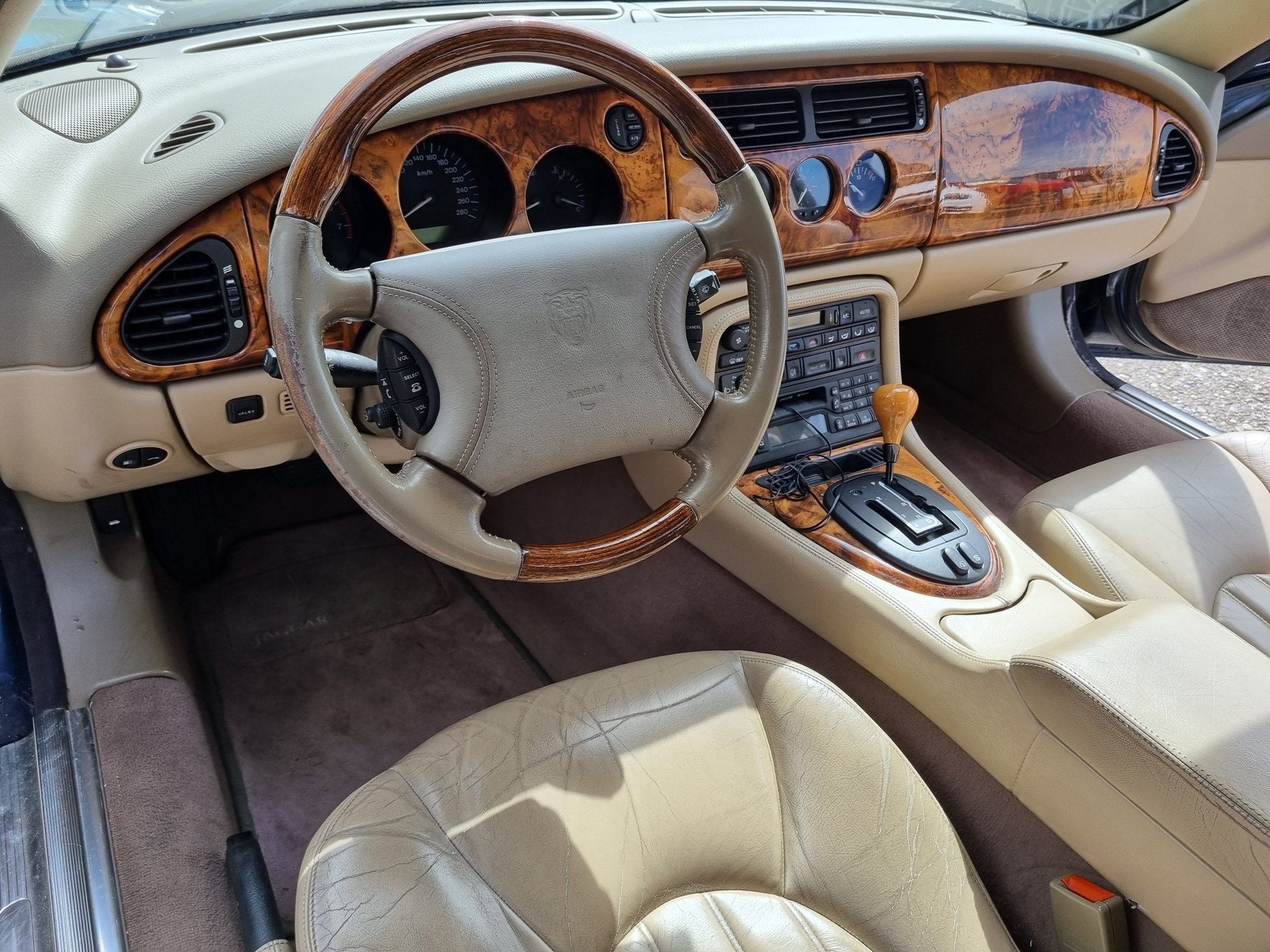

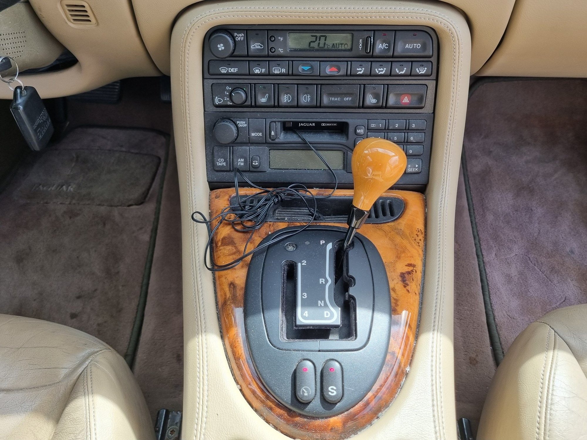

here are a few of the photos that I have:

I can see what perked your interest.
The stance looks good and the body shows no flaws from this view.
Shows normal wear for a high mileage car, steering wheel wear and sets need attention.
Go for it and give it a was job and come back with a picture that show what a beauty it is.
