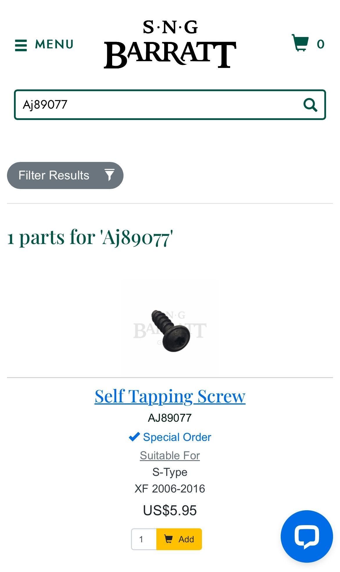

It looks like I need a new right cam cover for my 4.2 non supercharger engine. The SNG Barratt catalog shows part AJ89077, but that search produces links to screws.

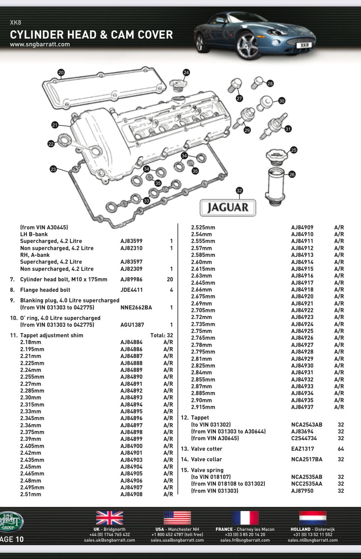

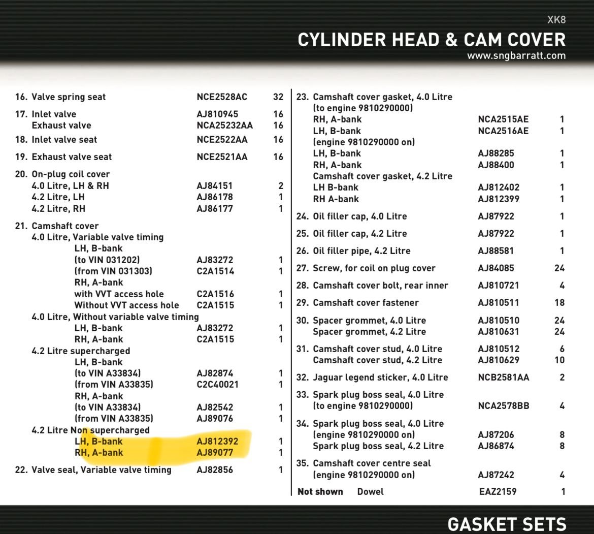

Correct. Also, any help sourcing the correct part number would be great. Attached are pics from the SNG catalog. I’m referencing part #21, right hand side, which looks to be part #AJ89077, which seems to be a $6 screw.

Not sure where SNG got those numbers from, although these have changed a few times over the 4.2L VIN range
Here's what JEPC has to say. VIN A30645 is the intro of the 4.2L
Those part #s show a supersession route to AJ88612, which also shows it's been superseded, but Heritage shows it as the most current, although unavailable
https://parts.jaguarlandroverclassic...aft-cover.html
FWIW, the X150 4.2L shows different part #s yet again, along with a couple of supersessions.
There seems to be a crossover from the aluminium-bodied XJ up to VIN G49700.
Breaker's yard?
