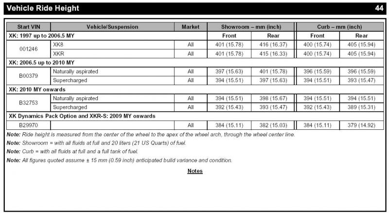

Let me add to Brutal's comments that 13 year old springs will also cause the front to sag and the camber to go out. I replaced my spring pads and thought it made a big difference. Then I replaced my 15 year old springs and it made a lot more difference.
Check your ride height per this chart and see where your car is. To measure it, park it on a flat even surface like the concrete of a weight station or large parking lot. Before I changed my pads and springs I was down over an inch on the driver side. Pads made about 3/8 -1/2" difference. The springs made the rest and they were not evenly sagged on left and right.

Your alignment looks like that of a car that has sagged about 2" (or has been lowered 2") . Even the green driver side front could be red unless they aligned the car with 200 lbs in the driver seat. The excess negative camber in back is the tip off of sagging/lowering.
Measure the distance from the center of the wheel to the center of the wheel arch on all 4 corners and report back.
Shock mounts/spring isolators/new shocks will usually bring everything back into spec.

USA LHD automobile:
Driver-Left-Front 14 1/2 inches, @ 37 cm
Passenger-Right-Front 15 inches, @ 38 cm
Driver-Left-Rear 16 1/2 inches, @ 42 cm
Passenger-Right-Rear 16 1/2 inches, @ 42 cm

You want close to 16" in front/back to have factory camber. Is the foam around the upper shock nut crumbly?
In back its weird its still -1 degree at 16.5". The only way to change this is with thicker half shaft shims.
