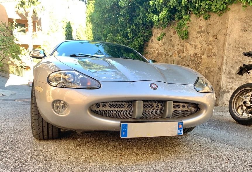

Hi Guys. This is what we did on mine.
We fitted a custom inter-cooler radiator with larger frontal surface area and a thinner cross section of 1”. We fitted a lightweight, aluminum, paragon bumper beam, to increase air flow across all the radiators then drilled it out to the max. we lowered the front registration plate for better airflow through to the radiators and fitted the upgraded Bosh high flow circulation pump. The system gets flushed out about every two years and the radiator checked and cleaned for bugs and dirt nearly every Sunday. (The cross beam has now been painted black to hide the lost teeth look). I've looked at the other cooling options but each has its downsides. The car is running great, it works, it doesn't overheat but I'm always looking for something more.
The big toothy grin!!
