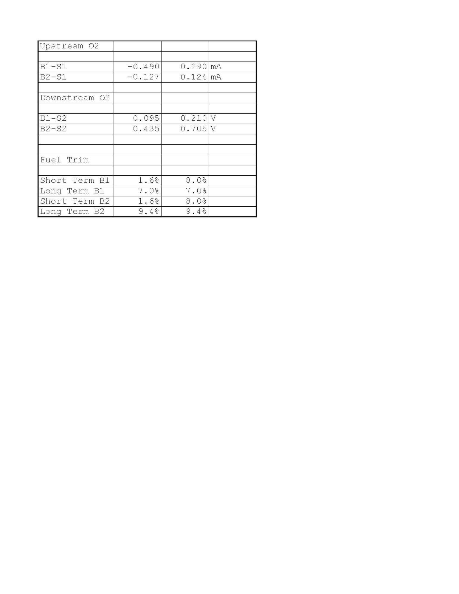

As far as codes I sometimes get a P1799 - CAN transmission control unit/ABS control unit malfunction (but this seems to come and go). Then I'll also get a P1797 CAN transmission control unit to engine control unit malfunction, (also seems to come and go). Then the one that drives me crazy is P1260 Security Input./ Theft detected. vehicle immobilized. Theft detected - engine disabled, which obviously means nothing since the car is still able to start and be driven.
There are no codes for bad O2 sensors or anything else.
This is what I get on the live data readings:
Not sure what the MIL is.
Mileage is about 64,500 on the odometer.
Joe

NBCat's Avatar
Posts: 6,068
Likes: 2,983
Next step is to determine the available voltage. Using a voltmeter, what is the voltage across the battery terminals with the ignition in the OFF position for thirty minutes or longer? there should be a minimum of 12.6 volts available for all the modules to function correctly. If there is less than 12.6 volts indicated on the voltmeter, charge the battery for five hours at 2 to 5 amps and retest. if the voltage shown on the voltmeter is still less than 12.6 volts, the battery is suspect and must be replaced.
Many random DTCs and instrument cluster warnings are the result of low available voltage.
