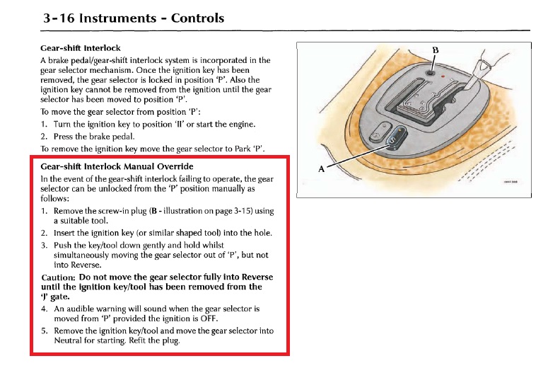

Can you hear the Gearshift Interlock click when the brake is pressed? If not, release it manually as follows (see the section I've boxed in red):

Fuse No 7, 15A in the Driver's Side Fuse Box protects the supply to the Interlock Solenoid. Its failure could cause part of your problem. Other contributors to the solenoid not operating include the brake pedal switch and the Not-in-Park microswitch in the J Gate.
