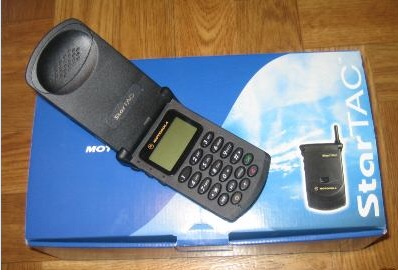

That looks like a StarTAC holder. Here's a StarTAC 130:
Only Jaguar StarTAC's worked with the steering wheel controls as they had bespoke compatible software.
Very strange, I've tried StarTAC 130 and it didn't fit in. Couldn't find any Jaguar Star TAC (there is some pictures in the web, but none for sale).

I'm not an expert here and this is dim and distant, but my fathers Stype v6 from a similar vintage had the star tac 130 and the holder didn't look like that from my memory? I think it looked more like this - http://www.benzworld.org/forums/atta...one-cradle.jpg
Also from obscure knowledge from refreshing my own car purchase, I think I read the jag vs standard star tac are identical phones with different firmware. I think I also read they can be reflashed, if you can get hold of the software and correct cable...
